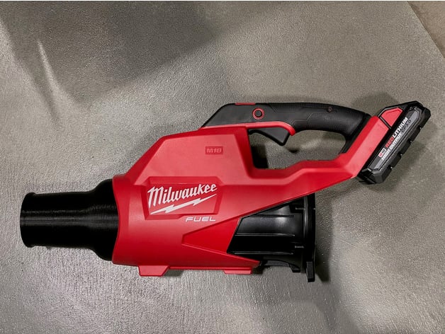

I found a stubby nozzle for the Milwaukee M18 blower on Thingiverse. Will be even better for blowing off a just washed car.
Printed in Polymaker ABS on an Ender 3. It took 33 hours to print with 25% infill, 0.4mm nozzle and 0.2mm layer height at 260/110 C.

Looks good! Wow 33 hours! I think I'll do it in PLA+. Then I can crank it out in 9!

That came out great! Already setup well for ABS I assume? I've got the teal version of that and think PETG would work well...but well done!
pwhittle
May 9, 2011
252
Woodstock, GA
I print ABS almost exclusively. It took quite some work to get to the point of printing ABS reliably on an Ender 3, but now that is my default.
Round models like this need no special adhesion tricks. Anything with a square corner gets mouse ears added in Cura to hold them down.
i originally bought the 3D printer to print enclosures for a PCB I designed for an electronic toilet controller in our motorhome. I have printed about 150 of these now, the first 50 in PLA, and the rest in ABS.
9C336880-BA4E-402E-B622-D150C2FF1DDE.jpegAC685920-18A7-4CC5-A0FE-977C9F8D032D.jpeg1519AED7-725F-455B-8377-887C52256DAD.jpeg
The FulaFlex print surface was a game changer for adhesion when hot and release When cold. The FulaBed is a great flat surface that the stock bed did not provide.
I have a roll of PETG to try, but haven’t tried it yet as the ABS printing is working so well.
