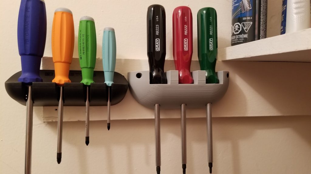

PB Swiss didn't have robertson drives (popular in Canada), so got a set from Gray. Made a tray for them similar to the PB Swiss trays.
STL file can be downloaded here for anyone who wants it.
Share your STL's guys!
