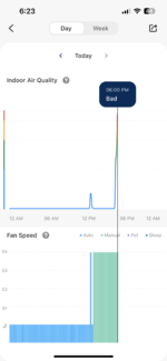

Looking forward to see what you think of the filter. For now I've just been running my HRV constantly when printing as it draws the exhaust air from the same room, but I would like some sort of filtration system instead of just relying on that.

not sure how much truth thre is to the onboard sensor but it thinks it did a bang up job.
