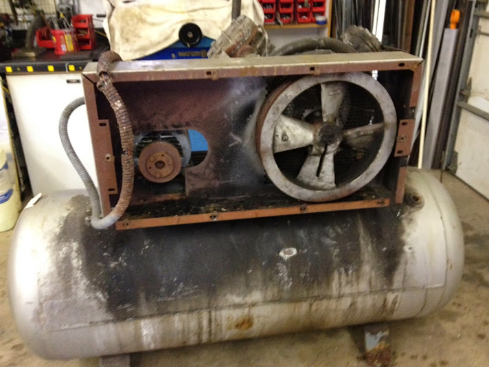

A little background on that compressor. It came from the same auction as the sandblaster?./? I knew when bidding it was inop. What I didn't know was it was in a basement with no elevator. I was hoping it would be an easy fix - really I was hoping it was an electrical issue as it was 3 phase and I would have to repower it anyways. No such luck. After using a skidsteer and an old countertop we were able to drag it up an exterior stairwell. Oh and it weights in at about 900lbs. Here are a couple of pictures of what I started with. (The work was done at my dads shop)
In the end it ended up having a busted cyclinder and a broke rod. It got a complete rebuild from the bearings up, a new baldor 5hp single phase motor, and a new paint job to match todays IR compressors. The compressor is a model T30 253. I ran a cfm calc on it once it was finished and it puts out 17.6 ascf @125 psi - not to shabby. The biggest and best surprise is how quiet it is- only 80 dbs at 6 feet.
