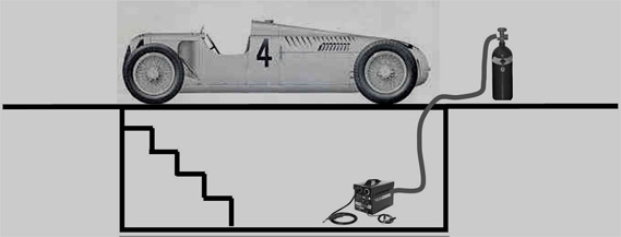

Lifts are great and all... But you know what has been intriguing to me lately? A simple garage pit. You don't see them much these days short of quick change oil places. Why, ...

Most local councils have banned them due to people having been asphyxiated by oxygen depleting gases that collect in them(Like CO from exhausts)and explosions caused by vapours.
Places that work on heavy equipment generally still have them but most now have forced ventilation.

Or how about heavier-than-air CO2? That will kill you also - I love how the picture in the OP has a tank of CO2 leading down to equipment in the pit... lol
These are great for heavy equipment or commercial applications. The catch is that they necessitate expensive commercial safety features and construction.
