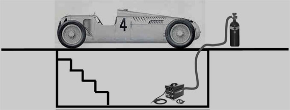

Lifts are great and all… But you know what has been intriguing to me lately? A simple garage pit. You don’t see them much these days short of quick change oil places. Why, exactly, is that the case?

Most local councils have banned them due to people having been asphyxiated by oxygen depleting gases that collect in them(Like CO from exhausts)and explosions caused by vapours.
Places that work on heavy equipment generally still have them but most now have forced ventilation.
I kinda like the idea of a pit in a garage. Maybe not for the normal Joe Schmo, but for some, it fits.
Do you know what type of ventilation system these places use? I wonder if you could legally put one in a home with the proper ventilation of if building jurisdictions just figure they are too dangerous without the proper training that service centers provide.

That pit can collapse and bury you alive. In construction, the walls of a trench must be braced before a worker can enter.
Not necessarily. It depends on the depth and type of soil. Seeing as HTGTS350 stated his was in bedrock, I believe that would exempt it from needing any shoring.

Having done trench rescues, I won't go above my waist in a dirt wall trench that is deeper than wide. More power to them if someone else wants to, but I won't. Those walls close at over 45 mph (66 fps) so you'd have .2 seconds to get clear, and contrary to popular belief most trench collapses that kill don't give warnings. Dirt weighs about 100lbs per cubic foot and people have died covered by 1ft of loose dirt (that's a 400lb person sitting on your chest). That's how I was trained, and the collapses I've seen bore mute testimony.
I know plenty of people have worked in trenches like that their whole lives without a problem, but it's surely something to consider. I rather save my luck for other things when possible. :)

Or how about heavier-than-air CO2? That will kill you also - I love how the picture in the OP has a tank of CO2 leading down to equipment in the pit... lol
These are great for heavy equipment or commercial applications. The catch is that they necessitate expensive commercial safety features and construction.
