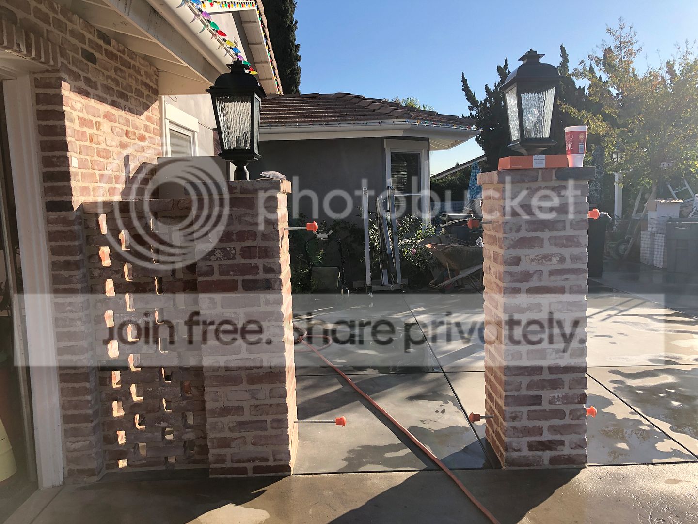

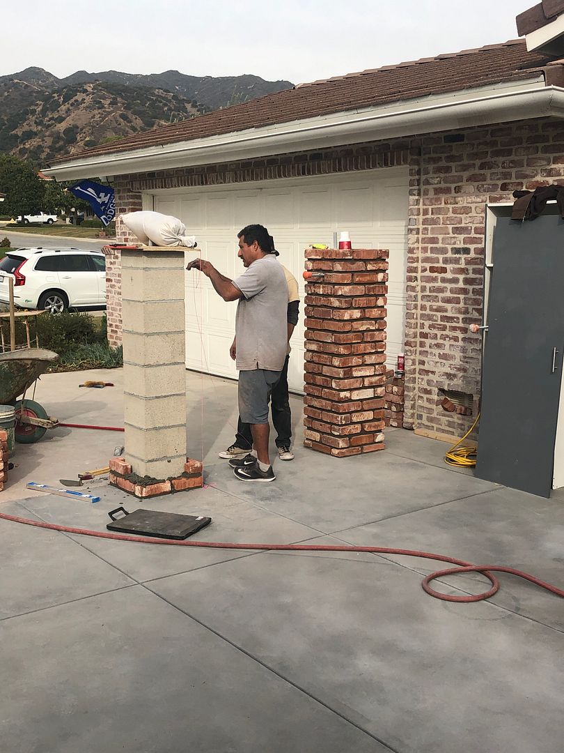

Latest:
1st of the columns to be veneered in brick. He did a very good job - my dad was a career brick mason and I worked with him on weekends after I was about 11 or 12. My dad was a helluva lot faster but in those days brick was used commonly for construction. Now, it's mostly for decoration only. All the brick on these are sliced down the middle, not full width.

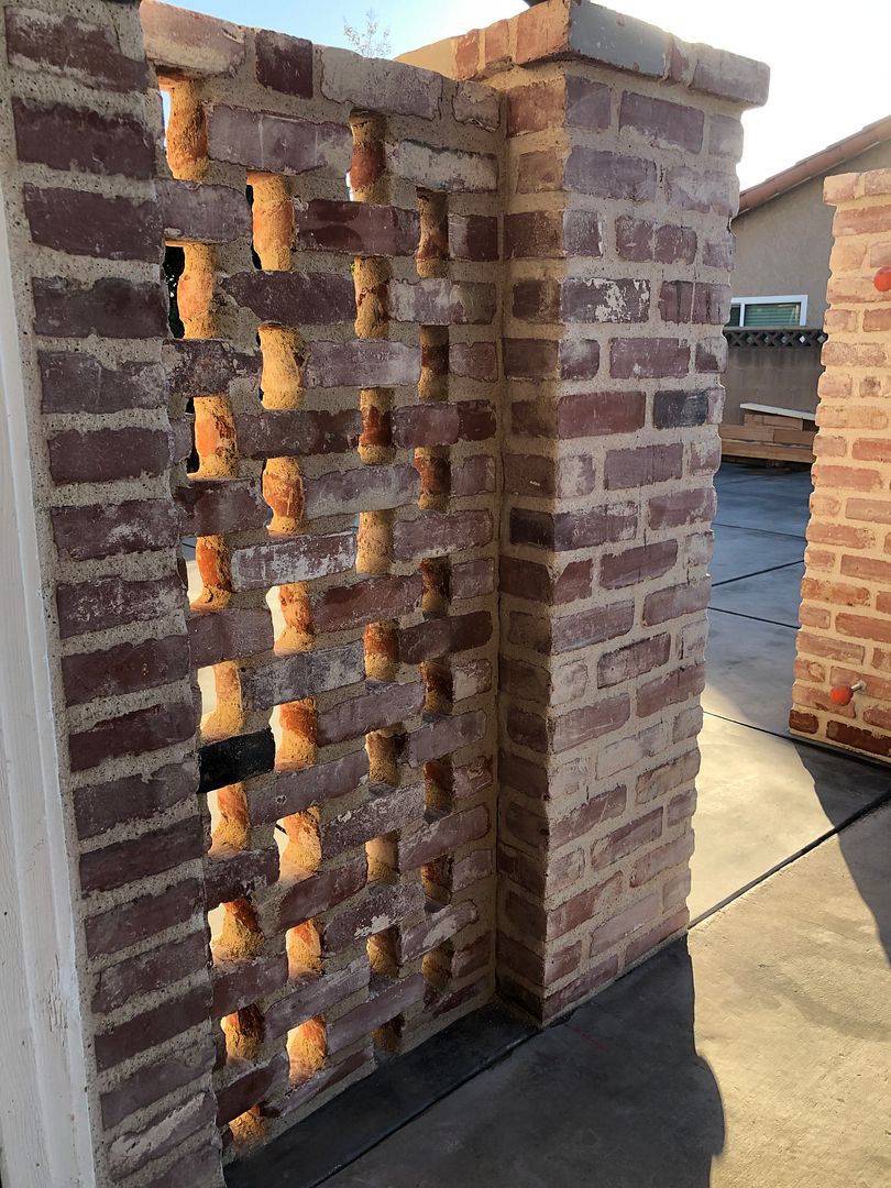

From the picture above on left - the basic concrete block column. On right after brick veneer has been applied, and below this final appearance using white cement in the mortar and sorta "washing" it over the individual brick to match the house veneer.
There will be a narrow brick wall between the column and house leaving wide spaces between brick so the dogs can "watch". No way to do a doggy window in the PVC gates that wouldn't look odd.

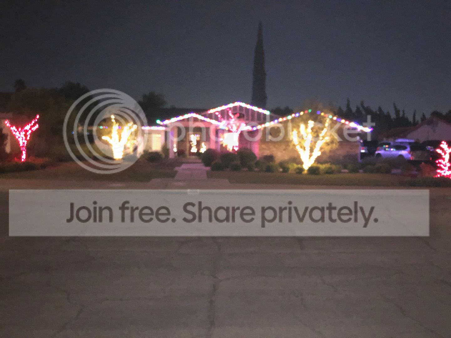

Christmas lights went on the new house for the first time yesterday. What I used on the old house was not remotely right or enough for the new house. Plus, the lightweight concrete roof tiles are damn delicate. Had to walk like on eggshells to make sure I didn't step on an under supported area or they will crack. Mostly crawled around on my belly.

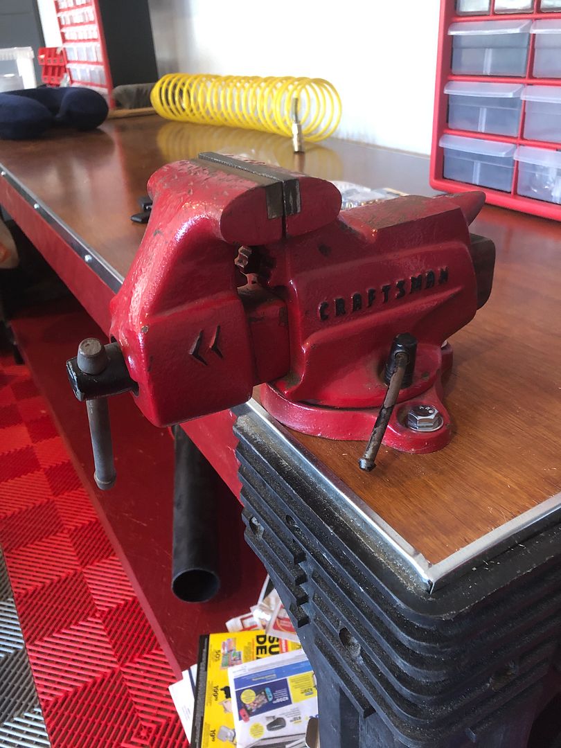

Today is my birthday so I took the day "off" and played the day away in the garage listening to sportstalk radio and futzing around with my stuff.
Finished the wooden shelf above my clean bench and also mounted my little Craftsman vise. Yeah, the paint needs refreshing and that swivel bolt straightened out!

Happy Birthday Dan. Your workbench and Christmas lights look great. I have couple of those vises too.

The vise has always served me well despite my abuse! But since coming to GJ of course I HAD to get a big honking vise - my manhood was at stake, ha ha. I found a big old Columbia I still need to clean up and find a replacement jaw for. Then I'll mount it on my small but heavy steel welding/"persuasion" table.

A question about the brick-work: is the wide mortar a 'thing?' I'm no mason, but that seems like a lotta mud. I believe in Florida with the HVHZ (high-velocity hurricane zone) requirements, a wall would need smaller joints to meet the wind-load codes. The 'open' brick pattern for the dogs, despite being able to 'pass' air, is something I doubt could be done here.

Thanks for your interest. I got the term "whip" hose from here. I've read a few guys use that term.
The width of the mortar joint on the brick work is standard here. I always thought it was standard everywhere for masonry and I spent my entire career as the Project Quality Manager for the Metro rail work in Los Angeles.
My Dad was a brick mason and his work always had joints this wide. But they looked different because his were usually raked or sometimes tooled to a U shape. In my case you can see the house already had the white mortar troweled flush when we moved in which results in the white "wash" on all the brick. The lattice design was my dad's though I've seen others use it on work in older parts of the area. I remembered it when we were thinking of cutting holes in the new gates that are being built now.
Back in the day if one of my dad's clients wanted the white mortar look he used lime in the mix to give it this look. On this work the mortar used standard gray concrete and was raked about 1/2" deep, then they mixed a finish mortar using white cement and put it on top of the gray mortar. I think you can see the darker color in one of the pictures I posted before the columns were finished.
