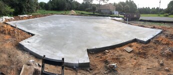

Finally have a bit more progress today! Been a long two weeks getting the slab ready but we passed all inspections with flying colors. Today despite Mother Nature throwing a wrench in our plans they poured the slab today. 81 yards in the mono pour of 3000 psi with fiber mesh. Between the verticals in the slab every 6 feet extending 8 feet in the slab. 3 number 5 rebar in the 24x24 footers I don’t think we are going to have an issue with cracking other than where we want it to.
Tomorrow we will place our (8) CMU piers. Should be 13.5 courses high each, 2 block squares. While that is going on we will be laying everything out for framing on Thursday. Hoping that in two weeks pending weather we should have a shell. If we play our cards right the windows and doors hopefully come in ahead of schedule. If we can get those here we stand a chance of getting it done before Christmas.
