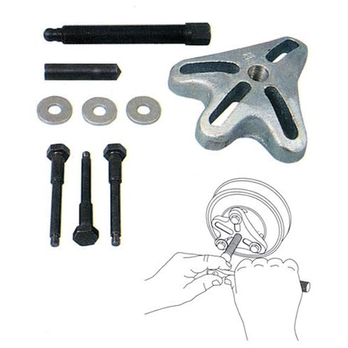

3 Piece Three-Jaw Puller Set=Fail
I only used the 4" one and destroyed it in every way. It never got my harmonic balancer off. The middle threaded area stripped,the bolts on it bent and the pointed tip crumbled.
you really did not use this type of puller on a harmonic balancer
:headscrat
you need a puller like this.....
when pulling a crank pulley you need to pull from the center of it, and i have been know to use the blue wrench from time to time just don't melt the rubber in it
The balancer i have requires the use of a three arm puller. Its a 6.0 liter GM LS motor. I have a puller like the one you posted a picture of and it is not compatable with this type of balancer. Here is a picture...
