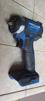

HERCULES 20V Brushless Cordless, 3/8 in. Compact, 4-Mode Impact Wrench
FAIL
I have a few of the 20v Hercules tools that I use everyday at work and this is the only one I have found to be worthless. Wouldn't remove a brake rotor bolt that is torqued to 48ft.lbs. I tried with a 5ah, a 4ah extreme, and an 8ah extreme battery's
I have found a few videos about this tool on YouTube and posts on forums and they have a similar experience with it. It just *****...
I did find 2 videos where guys have taken the 20v impact driver that has more power and converted them to 3/8" drive with dewalt anvils and I decided to try the swap and it's a win. The anvil did need a little bit of massaging to fit but it wasnt anything major.
The conversion is shorter, a bit lighter, and has the 3 lights on the front. Second picture shows them stacked and the difference in the noses20251114_230231.jpg20251114_230302.jpg20251114_230314.jpg
