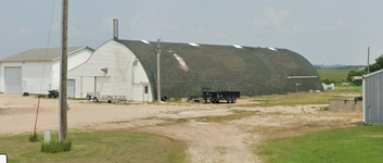

Flyover state #4
Central hall is 40 by 54
Printer room is 16 by 54
Office is 16 by 24
