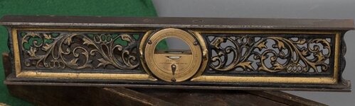

They’re a bit “left field” but an electrician friend uses these Ebisu levels. Made in Japan.
They seem to specialise in the smaller tools, but make a huge range, including different coloured vials and illuminated models.
