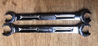

So here are mine that I could find. There may be more...
Definitely dupes for the Craftsman and Thorsen:

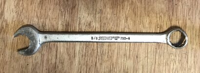

But one orphan:

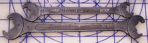

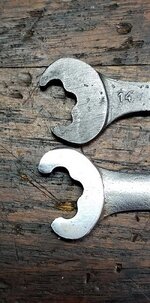

A couple of my Surpans (I have more in the TVan...):
The Imperials and a Kelsy Hays:

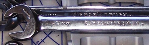

and outside Lugz's Waves; the Gearwench:
and not talking about the Box end - Look closer:
