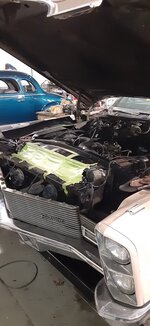

Mary Kay update:
We were worried that perhaps that Mary Kay was going to need a new carburetor but now it seems that can be fixed. Will solve the cold start problems I was having.
One of the exhaust manifolds is cracked. They will remove it to see if it can be welded. Otherwise we will need to find a new one.
They are working on inspecting and replacing things likes belts, hoses, fluids etc now. There was no specific problem here - I did just as them to replace wear items as needed and do to a general inspection of the engine, suspension and brakes.
They have not yet looked at the power steering leak.
They are ordering seat kits now. They will install those in-house. They will bring the car to another shop to replace the convertible top.
They inspect to make consistent progress on the car now - at least the mechanical items. They are running a little behind on bodywork so the rust repair on the front fenders may take a little more time.

I just talked to them this afternoon. Here is the full update. As noted before one of the two exhaust manifolds was cracked. The took it off the car and they were able to weld it back together. The heat did cause some distortion so they had to mill it to get it flat again. That’s all been done and the engine has been fully put back together and now runs well. The had earlier fixed the carburetor problems so two of the three main mechanical problems have been fixed.
They still have to fix the power steering fluid leak and that is next on the agenda. They will start working on that right away.
They also ordered seat covers. While the carpet was in fairly good shape they suggested I might as well replace it as long as the seats were coming out. I told them to go ahead with new carpet. We might do door cards as well.
It might be a little wait until they can start with the small amount of rust repair that the car needs (bottom of both front fenders) I think they are short staffed in that area of the shop. When they repaint the front fenders they will also repaint the convertible stop mechanism. Likely we will need to do some work to the convertible top well as they say those are always beat up, which makes sense.
when that’s all done we will have to taken over to the local shop that does their convertible tops.
All and all there have really been no surprises thus far. I think Mary Kay was always a pretty solid car and these guys know what they are doing so this is what I expected. So far so good.
