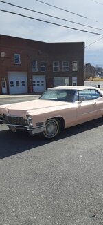

I just talked to them this afternoon. Here is the full update. As noted before one of the two exhaust manifolds was cracked. The took it off the car and they were able to weld it back together. The heat did cause some distortion so they had to mill it to get it flat again. That’s all been done and the engine has been fully put back together and now runs well. The had earlier fixed the carburetor problems so two of the three main mechanical problems have been fixed.
They still have to fix the power steering fluid leak and that is next on the agenda. They will start working on that right away.
They also ordered seat covers. While the carpet was in fairly good shape they suggested I might as well replace it as long as the seats were coming out. I told them to go ahead with new carpet. We might do door cards as well.
It might be a little wait until they can start with the small amount of rust repair that the car needs (bottom of both front fenders) I think they are short staffed in that area of the shop. When they repaint the front fenders they will also repaint the convertible stop mechanism. Likely we will need to do some work to the convertible top well as they say those are always beat up, which makes sense.
when that’s all done we will have to taken over to the local shop that does their convertible tops.
All and all there have really been no surprises thus far. I think Mary Kay was always a pretty solid car and these guys know what they are doing so this is what I expected. So far so good.

Quick Mary Kay update: The mechanical work that I planned to do to the car is now basically done. As i updated previously they have rebuilt and cleaned the carburetor and fixed the choke, they welded up a broken exhaust manifold and replaced basically the entire power steering system. More recently they also replaced the oil pan gaskets some hoses, resealed and put new bearings in the rear axle and replaced the ball joints. Finally they took it for a long test drive this week and basically said it’s complete mechanically. I had hoped to have them repair the rust in the front fenders but Ive decided not to do that. They are short staffed in the bodywork department and I would not have gotten the car back for summer if I would have waited to have them do that work. I still need to get the interior and top work done. I’m also going to get new tires. They are not worn much but they are old. And yes, I am planning on driving the car home from Virginia. Hopefully in May or early June.

Is that the shop in the background that’s doing the work?
Mary Kay looks good in the sunshine. Ready to head west!
Mechanically she is all ready. Just have to do the cosmetic stuff. And yes that is one of a few building WW Motorcars has in Broadway Virginia.
