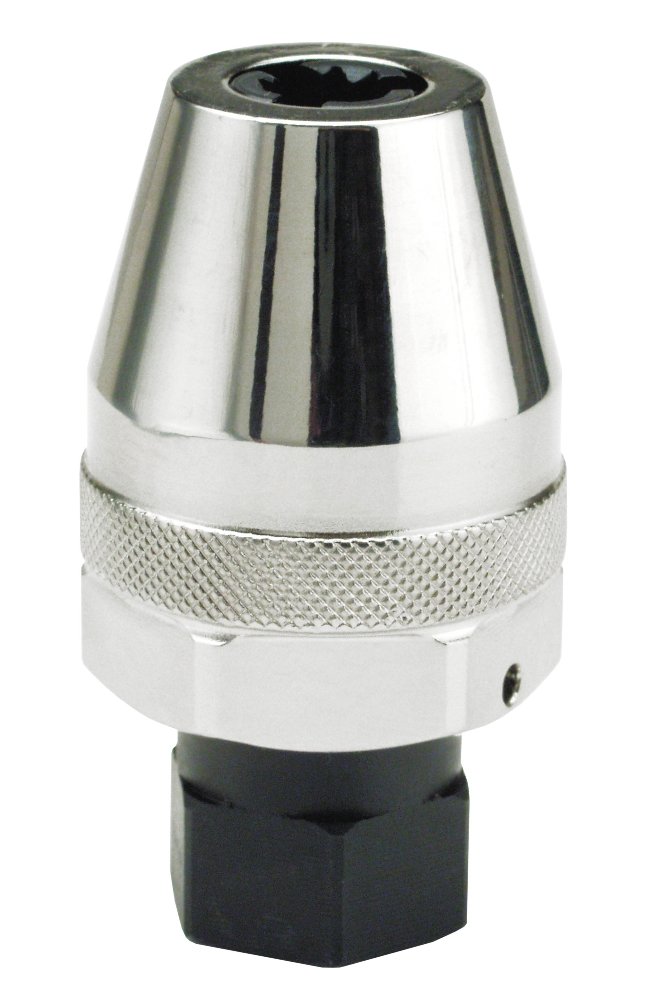

This thing works pretty damn good. It's kinda like a 360 degree pipe wrench since the chuck threads are left handed. Might be a touch too round though. I know it hates flanged heads that tend to taper outward when they round.
back2class
Jan 7, 2009
2,723
Will never work on this. That nub will sheer off before those threads come loose. The mass of steel left to grip on just does not have enough strength IMHO.

I ripped rusted exhaust manifold studs out of a 7.3 with one, if the threads are that bad I expect it'd tear out the aluminum before shearing off the head. Never had a problem using it on anything > 8mm and not tapered from using pliers.
Including things that were glowing orange... throw some heat at it!

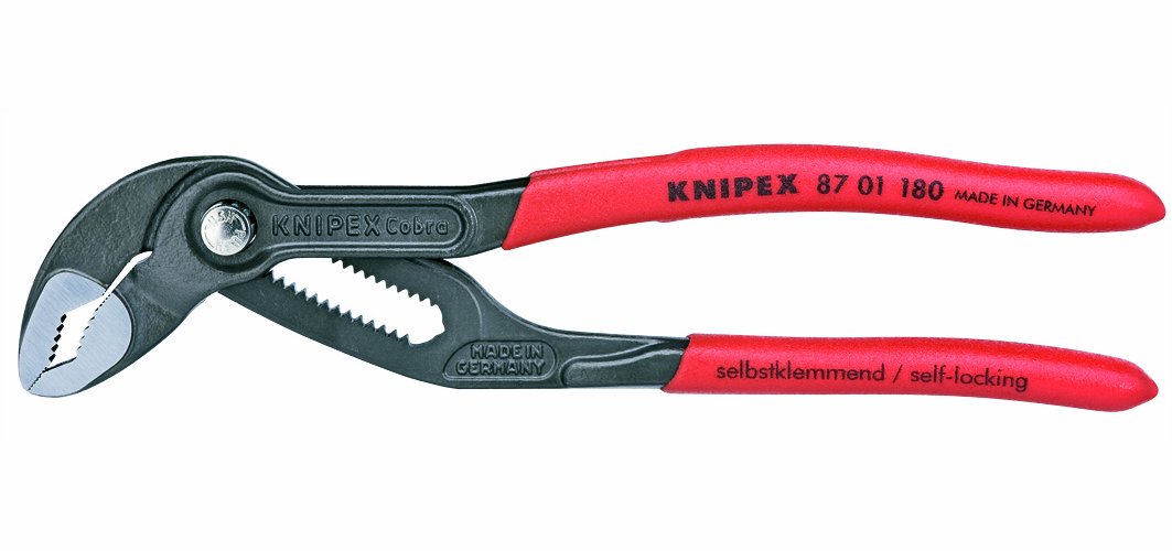

Well, i kinda havent checked my messages here on Tapatalk, so havent realized how many replies i got.
Anyway.... Lets say PRAISE TO KNIPEX. I ended up welding a nut to the thing, and while still hot, grabbed with my Cobra's, kept tension with one finger, and hit the pliers with a deadblow. Cracked loose instantly.
For those of you that are saying Knipex are not as good a Vise Grips because they do not lock..... I disagree. Now if someone made pliers that have a design such as the Cobras, but as you pull harder, the pliers keep ratcheting/locking down; that would be badass.
And the twist sockets work excellent as well, to those who asked. I got them on there and get an excellent grip. The bolt was just too tight.
So in the end, i believe the impact broke it loose. My teacher was telling me that students would sometimes pull and pull on nuts to break them loose, but couldnt; and he goes, whacks the breaker bar with a deadblow and it pops loose.
Thanks everyone! This thread did teach me a lot of valuable, plausible techniques that i would have otherwise never thought of.
