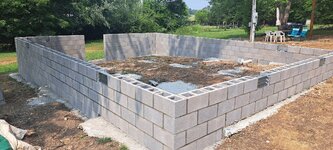

I got the last line set for the master bedroom ran down the wall and under the house, then we finished drywall in that room. Also finished the kitchen area. Only thing left to do now is the stairwell area but I need to get some nice 4x4 posts for the railing first. I'm bolting the upstairs ones solid against those 12" I-joists while that section of ceiling is still open.

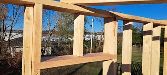

Earlier this week I cut down a standing dead ash tree.......I have a few around here. This morning I hauled the main trunk part down to a local guy that has one of those portable sawmills. And a few hours later I went back and picked up some wood!!! The 4x4 posts are going to be the posts for the stair railing. And a couple other of these 2x12's will be transformed into a nice sitting bench for my son's porch.

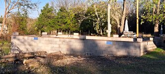

I set my ladder back up on the scaffolding and hung the top portion of the stairwell today. I also utilized some scraps and started under the staircase as well. This will get a door and become useful storage.

wendle
Jul 19, 2018
28
NSW,AU
It's been standing dead for over 2 years......you think it might still be sappy? I have a moisture meter, I'll check 'em out.
Edit: I checked the boards. They range from 28-39% moisture!! I never would have thunk!!
Standing dead trees don't know that they are dead. :lol:
Capillary action will keep pulling moisture out of the ground.
Even a sawn log sitting on the ground, end grain down, will take much longer to season.
(y)
