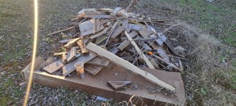

Impressive!
This is the difference when you really put the pencil to it and order the lumber required so as to have minimal cutoff waste. The average GC probably doesn't care too much couse it's YOUR money and not HIS. They will tell you to figure an extra 15% AT LEAST for waste............I call a HUGE B.S. on that!!

Well done, that is an insanely small amount of waste for your build! 👌
Thanks! I knew some of you guys who have been around build sites would get a kick out of that. Even the guys who set up the trusses and sheathed it all for us commented about how MUCH WASTE there usually is at the jobsites. I spent many hours with my pencil drawings........uh, I mean.........blueprints LOL!! I double and triple checked, trying to squeeze the list for the best outcome.

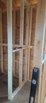

Also today I added the short wall at the end of the tub, and got the pocket door frame put up for the small downstairs bathroom.

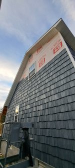

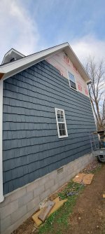

Well, last weekend I rented a lift again to finish the siding...............never got one piece hung! The basket wouldn't tilt, so as you raised the arm it tried to dump you out!! The bigger one was already spoken for so they gave me a discount and I picked it up today. I get to keep it until Monday. This afternoon I finished the last bit of soffit and fascia on the remaining gable end. I don't like the heights any better than last time!

Christmas was about 78* !!!!! But it was Christmas, so we didn't work on the house. Then I got about 2 pieces of siding hung this morning and got down in my lower back. I had to get down and stretch and walk around just to keep spasms at bay. So wifey went up in the lift and got the rest of this gable side hung today!!

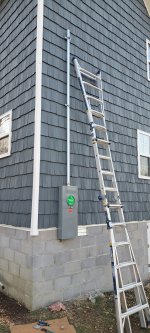

The engineer from the power company finally came out. They can move the old pole out of the backyard no problem, and he told me where to mount the meter base. I picked up MOST of the electrical stuff and started drilling & pulling wire today !!

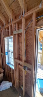

Got some more wiring done today. Living room and downstairs bathroom are now both done. You can see the breaker panel area starting to get populated with wire ends, and one wall of the bathroom.

Today, after LOTS of measuring, I drilled a 3" hole through the block foundation EXACTLY where the conduit comes into the back of the meter base. I used lag hangers for the top mounts and carefully opened the siding JUst enough for a 1.25" aluminum spacer. That way I could fully tighten the meter base against the sheathing and 2x4 backer I put in the wall.....all sealed up of course. Then on the bottom, I cut some PVC trim board down to space it out plumb and anchored right through to the concrete block. I also drilled through for the mast supports and set the spacing on those....also reinforced inside the walls with 2x's. I have to trim off the rear threaded rod so it doesn't come right through the drywall and into the room! And I picked up the 2/0 copper to run in to the breaker panel. Maybe tomorrow I'll get this finished up.
It is satisfying to do well.
Unfortunately for most people they don't have the luxury. When it is the architect at $100+ an hour, or even a draftsman at $40 or so an hour, it doesn't take much time to add up to way more than a pile of lumber scraps.
In Upstate SC, you can't find a framing crew for less than $150 an hour, most are running $200+ an hour. Minutes cost money. Cheaper to blaze through and not worry about it then to stop, think, manage your cutting schedule, keep track of cut offs, etc.

Oh, I understand that........BUT, if the 'cut man' had any semblance of conscious brain activity, the cut-offs would sit in an organized pile and be used instead of discarded. It takes zero time longer to guess the length and throw down like cord wood, compared to grab the board and chunk it in a pile. Same for cutting a board at the better side away from a knot or split.......if there is ANY brain activity at all, that's just an automatic act. The same money paid CAN do a much better job if there was any " I care" at all.

Today I got the service mast installed and locked down. I also blocked for the 2 lights/fans in the vaulted ceiling area and got those boxes put in. Then instead of finishing up the main power IN to the breaker panel I drilled holes and finished the downstairs wiring. Only thing left for downstairs is stapling the wires.

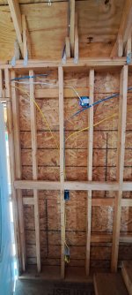

We wired and stapled and pulled and.........you get it. And the wiring is now completely roughed in....YAY!! Several pics.......because.

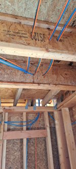

We got most of the plumbing stuff and then that arctic blast moved down. Of course we had snow and sleet and single digit temps just like about HALF the country!!! So for the last 10 days or so NOTHING got done. BUT TODAY....we ran all the CAT6a for internet AND poe security. We used some nice 23ga solid copper, double shielded stuff. Also ran some outdoor rated RG6 coax to the rooms as well.

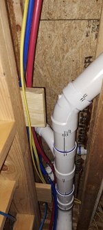

Last couple days........PLUMBING! Trying to fit the drains in and keep it sloped, and get the drops to line up with the Tees or Wyes........OH mY GOSH!!! Upstairs drains are done and the main vent is run. The mess under the utility sink is me trying to figure out how to get the trap AND the AAV to both fit up under it.
