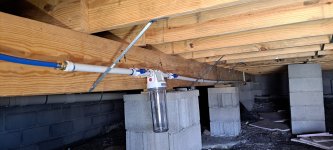

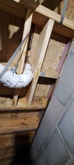

We've been 2 days crawling around and wollering in the crawl space.......FINALLY all the waste drain is DONE!!! Just need to finish up the supply. And where did the downstairs toilet end up...??.....right over a joist OF COURSE :rant:!! Well, it is what it is, cut it out and box it in!

With the exception of the shower and tub valves, the plumbing is DONE!! I installed a filter can with valves too because my son has a water well. After the 'pre-drywall' inspection and pressure test, all the water lines will be insulated

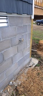

Finished all the plumbing, including the frost proof hose bib, and trying to wrap up odds-n-ends. We have an inspection Friday. I made the connection in the electrical boxes and ran the wires in conduit to the disconnects for the HVAC units.

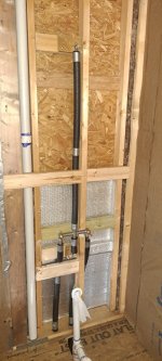

I put some plugs in the shower fittings today and opened those valves up. Then I used teflon tape and temporarily installed all the shutoff valves for the faucets and toilets in the OFF position. I put a pressure gauge in the end of the hot side line cause the water heater is not here yet. Then I got this brilliant idea to drill a hole through a garden hose CAP and install a valve stem. This way I could pressureize the whole thing with air throough the hose bib!!! It worked like a champ, I immediately found a bad crimp.......I actually heard it under the crawl space and saw the deformed clamp. No biggie, cut it off and recrimped. Next up was SEVERAL of the shutoffs leaking at the teflon tape seal......GRRRR!!! Unscrewed 'em all, wrapped up about 6 rounds on the threads, reinstalled.......OK! Everything looks good now and currently pressureized. We'll see where my gauge sits tomorrow afternoon.

Making good progress!! On the leaks, I have pretty much given up on white teflon tape. I prefer the yellow tape - it's thicker. And I do at least 3 wraps.

I wet inside all the valves with my soapy water spray and worked the valves a few times.....then I pressure tested again today. Held at 32psi for about 3 hours. I'm sure it's good to go. Then I worked on making more of these insulation baffles. The whole front is done and half the rear. You can see how I left about an inch air gap for the ventilation.

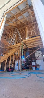

More ladder on scaffolding work today, here was my view. I spent MOST of today UP and DOWN and moving and UP and DOWN again and again..........whew. The radiant barrier is done, I can finally insulate this vaulted ceiling. It also got warm today so I grabbed the laser thermometer.........ambient temps upstairs in the lower 80's. Windows were closed and it was around 70 and sunny out today. Roof decking just about 110* and just under it on the radiant barrier........only a few degrees warmer than abient room temps!! It's doing it's job.

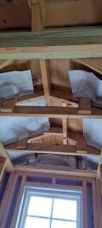

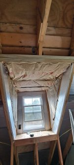

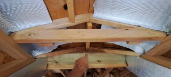

Today I got the Radiant barrier in the dormers. I've left just the peaks open and drilled holes (that I'm pointing to) for the draft to pass through. Then it can carry on into the attic and out. Then my wife insulated the one in the bedroom. As soon as she buttoned that up there was already a nice little wind blowing through those 2 holes! And IF there's enough radiant barrier left we will put it on the INSIDE of these dormers before drywall. She went ahead and put some around the window already.

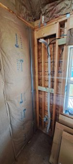

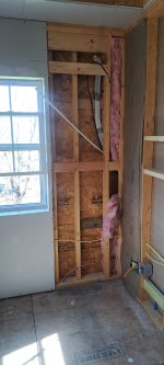

....more.........and MORE......INSULATING!!!! That slanted wall in the small bedroom is done, YAY! Most of the master bedroom is also done. I also sleeved all the pex inside and had some radiant barrier leftover so it went in behind the upstairs tub plumbing. I don't foresee any issues but that IS an exterior wall.

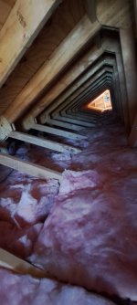

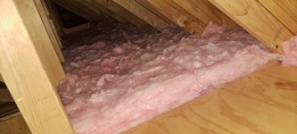

I started insulating the attic today. R19 batts in between trusses, then another layer of R19 laid perpendicular across the top.

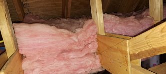

Same old, same old............insulating!! Itchy, ITCHY!!! So, why is this taking so long??? WELL,..I'm glad you asked LOL!! Arkansas is about 20 years behind the times. I went with 19.2" truss and TJI spacing. And since all the "well built" or "custom" homes around here ARE STILL PUTTING STUFF 24" o.c...........I had to special order all my insulation for 19.2" spacing. I did this through my 'Pro' account at HD and either the lady helping me didn't know how to do her job......OR, I actually couldn't break up my insulation order (had to order a pallet) of batts WITH facing and batts WITHOUT. So this means ALL the stacked insulation,...I have to take my little comb tool and scrape insulation off as I remove the paper. Also, I'm VERY picky about the way I do things so it all has to sit nice and tight with no gaps. That means slicing around truss members and wiring, etc. I also cut these nice little wedges to fit up into the baffling I made with the radiant barrier, nice and tight! I hung around 500sq ft today.
