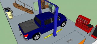

The Ole Barn Workshop by BigNuge-3D Model
Well, I put some time into learning Sketchup (downloaded the free version).
Here is the 3D version of my plans (to scale). This is just the workshop area itself. The open wall side of the model is only open to easily show detail. The open wall shown will be a closed off wall, with a large sliding door in front of the vehicle bay so I can get vehicles into the rear section of the barn.
