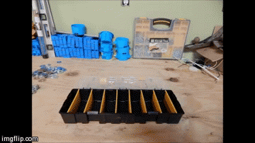

Did the floor.
Vapor barrier
2" foamboard
OSB subfloor
too a while, had to cut legs of bench
and the post is gone
Do not do this =p
I removed this post because:
It supported a beam for a roof no longer there, at some point the roof failed and they replaced it with a truss system and for no reason left half the center beam and two posts. Does nothing other then interfere with proper function of the trusses.
guess what... it was not attached to the beam, wacked it with a sledgehammer a couple times and fell right out..
and yes I checked with two engineers before I did this.
playing with timelapse
via Imgflip GIF Maker
