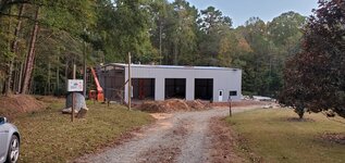

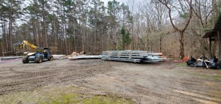

Building was delivered. Took 3 hours to unload. After heavy rains, i destroyed.my parking lot with the fork lift. I decided to start working on the grading to get all the water to flow better around the shop. 3 more weeks for concrete to cure before erection.

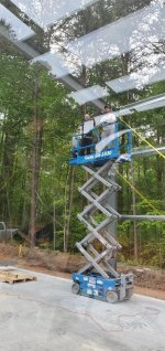

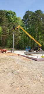

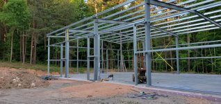

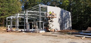

Big update... Skeleton is up. Rented a 39' telehandler and a 19' scissor lift, along with purchasing another 20' scissor lift. I feel like it was the perfect combo of equipment to get the job done. Rounded up a crew of buddies to help out. Other than some anchor bolts being set wider than the template, everything went up pretty smoothly.
Next step is to finish up the cable bracing, install base channel, then frame up 8 windows, and 8 doors.

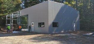

Well it looks like I haven't been keeping up with this post. Here's some updates. I put base channel around the perimeter, This allow both an exterior and interior mounting for the walls panels. Most basic buildings would just have a base angle for the exterior, then a separate angle would be installed later for the interior walls to mount to if you chose to do that.
Installed windows and doors. I used a local vinyl window company to make custom windows to my dimensions. Double pane, insulated, low e windows. Half price of anything at Lowes.
The doors were purchased with the building through Olympia. They are Plyco brand insulated thermally broken doors. (20 series iirc) I'm pretty happy with the quality.20210521_193229.jpg

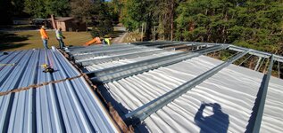

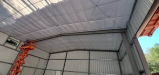

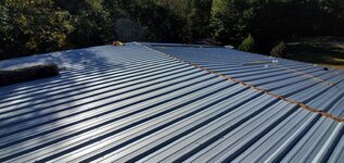

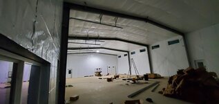

So my crew finally became available and it was time to start skinning the building. A crew of 5 guys and the plan was to skin the building, install all the insulation, and finish off all the exterior trim and gutters. From the point where I left off with all the openings trimmed, they figured it would take them 7 days of work to get the rest done.
We got the roof on just before the rain started, so had the rest of the day to start the interior insulation install. These pics are up to day 5 that the crew has been here. 2 days left to finish the exterior.. Half an end wall, the all corner trim, roof trim, gutters. Then finish off the rest of the interior insulation.

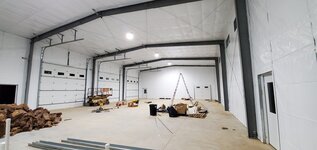

Garage doors are mostly complete. Clopay 3720 from Home Depot. 2" thick, R18.4. Big doors are 14'2"w x 14t. Small door is 9'2"w x 8't.
Doors took 6 months to get order fulfilled. Luckily, I order the early and they were in a warehouse waiting for me when I needed them. Clopay from Home Depot was the best option that I could find for a DIY install. Dealers for other brands wanted to do the install themselves. I needed to save some money. Doors were right around $11k "out the door" :)
Instructions said to use 2 track hangers per track. In my typical overkill fashion, I ended up doing 3, all made out of 2" 12ga punched angle iron. (Fastenal has for $30 10ft )
This was my first time installing a garage door at all, and I was able to do it all solo. The big door panels were 70# a piece, but more awkward due to their length. It took a long time to install these. First issue was my scissor lift motor crapped out on me. The wrong replacement motor was sent to me, so That ended up being a week delay, and a $300 repair. I ended up buying new 6v golf cart batteries for the lift as well, so another $400. (I knew it was coming, it came with 2 big 12v car batteries.)
My biggest issue was I didn't have a spot to mount the spring retainers. I should have looked at the door instructions to know where to put them, before the insulation and vinyl liner were in place. I had to cut the liner and go back and install some c Channel so I had something to mount the springs to. I did 2 per door. I'm not sure what a paid installer would have done, but i probably would have ended up having to live with some exposed scrap wood if I wasn't around to stop him.
If you've never had the joy of winding a 6" garage door spring, you don't know what you are missing out on. Going off of what I learned on YouTube, I was able to avoid injury. Everyone references the "horror stories" when garage door springs are mentioned, but it wasn't that big of a deal with the right winding bars.

You can see i the above pics, there is some light in the garage. I'm using 240w led ufo highbays from Amazon.
Brand: JOMITOP
240W High Bay LED Lighting Dimmable 36000 Lumens DLC Listed 900W HPS or MH Bulbs Equivalent 5000K Bright White Industrial Highbay Light, Warehouse Light Fixtures, AC 90-277v
They were $110 each, about $40 cheaper than the equivalent well advertised "hyperlite" brand.
These had a regular 120v wall plug and a separate 0-10v dimmer. Made it easy to wire temporarily with extension cords. I can cut the plugs off later to hardwire if I choose.
They are pretty impressive. I did the 240w version since the reference charts said to use them above 18'. I bought 9 lights. There will be 3 in each of the open bays. The 4th bay will have a loft I'll do something else there.
I mounted the middle lights with some of my leftover 2" 12ga punched angle. I just spanned the middle purlins and hung the light in the middle. The other lights were mounted with a piece of uni-strut, with 3/8" eye bolt, and a quick link.
Only the middle 4 are temporarily hooked up. Its easily enough light to finish the building. With a single light i could read a book at the opposite end of the building.
