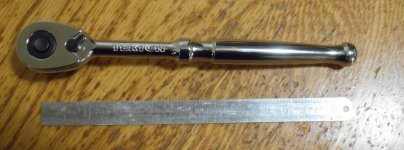

On a whim, ordered this unit last week from Ebay and just received it today.
Heavier and not as well-balanced as I would hope for, but those are matters of personal preference.
The QR design is evocative of the Indestro-Roberts model 2880 (same patent that was used in older Craftsman QR models.)
Not sure if I'll keep it or give it to the kid. He's a "lunk" weightlifter so he certainly won't have issues with it being heavier than those models I'm more accustomed to.

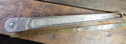

30,787
Ayrhead,
Nice! That's from the Bonney-Gray era (when Bonney bailed them out). Made by Gray with Bonney specs and dies. It's 3/4-inch drive, right? I have the Bonney version, which they called the Hercules, No. 4298.

Ayrhead
Feb 23, 2020
571
Ontario
Hi Lugz: Thanks for the info. Yes it is a 3/4” drive. Any idea what year(s) the Gray 98 might be?
Harry
30,787
Looks 30's to me. And, thanks to the Tool Archives, our open door/open source policies, the generous collectors who lent their catalogs for scanning, and twertsy's hard work in scanning them, we have a public access library that includes a few Gray-Bonney era catalogs, including a 1936, where I found your Hy-Duty ratchet on page 7. Enjoy the excerpt.
