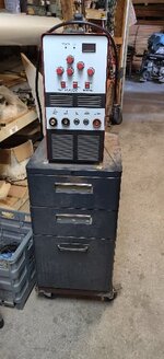

Has anyone used one of these office cabinets with drawers to use as part of a welding cart? Are there any negatives to using these? These can be had for much less than buying a HF side cabinet.

I have two exactly like the one pictured,
One for welding cart the other for air tools/rire repair stuff.
Notable features of this particular model is that it is properly weighted at the we bottom, it doesn't tip whenever drawer opened.

I have my plasma cutter on a similar Equipto 3 drawer unit, on a angle iron base with casters. Stores my torch & lead, gloves, shades etc. Quite handy

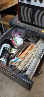

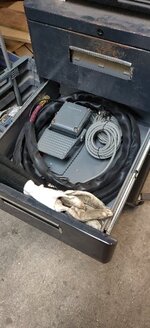

Yes. I used a filing cabinet that looks very similar to that. For my use it works really well. Bottom (large) drawer stores my helmet, gloves etc. Next (smaller) drawer has leads, pedal etc. And top drawer all the consumables and related things.
I built a base with castors and left enough room for an 80 cubic foot tank which is stabilized to the back of the cabinet with a chain. I ended up making brackets to hold the welder on the top.
I'll try and remember to snap a picture next time I go to the shop.

I pick up every free file cabinet i can and put wheels under them. Plumbing, electrical, grinders, etc. Just last night I saw small 3 draw with different sized draws and asked the owner about their plans. They hadn't decided so I mentioned a welding cart or I would be interested. It didn't come home with me...
Perfect for a welding cart.
