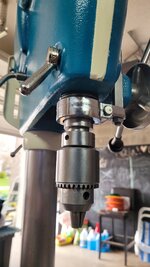

I haven't updated in awhile. I didn't do much over the winter (unheated garage) but have gotten pretty close to finished with the drill press itself. I'm still touching up the paint a bit, and I haven't touched the motor yet. I rebuilt and cleaned the chuck today, which was the most difficult part of the project so far. It was very difficult to press the outer sleeve off and back on with my vice, even after cleaning and lubing it. Felt like a victory when I accomplished it! Anyway, this is not an "I'm done" post -- just checking back in after getting moving on it again after a break. 😀

It's looking good. I'm still hoping to find the right thing for pressing the sleeve on and off. Did you come up with a good idea? I realize a spare chuck sleeve could work but I don't have one yet.

I scouted around Menards one day in the conduit and plumbing areas with the chuck in hand, hunting for a little section of pipe that was the right diameter. This was the best I found. It's a 1.5" conduit coupler, IIRC. It wasn't ideal because my vice would not open quite far enough to accommodate it and the chuck, but I managed to make it work.

That's pretty amazing. That's exactly what I used too. I did a very thorough search of one of the biggest Ace Hardwares in the country and that's the best I came up with. It worked but it's a little brittle so I did some damage to it. I'm keeping my eyes opened for a really cheap chuck that I can strip out for it's shell.

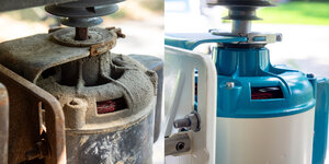

More tips on how I refurb those Emerson motors...
I clean the inside and outside of the motor rings in the end caps with acetone and mask with Dr Shrink tape. (Awesome tape... very sticky and kinda thick.) Don't forget to clean and mask the oil plug holes.
I use Grez-Off with a brush.
Rinse with water, but don't submerge.
Remask the outside for painting.
Pull the cap wire into the stator band if applicable.
Use whipped topping containers to "mask" the stator. Quick, easy and they fit perfectly.

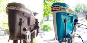

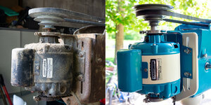

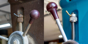

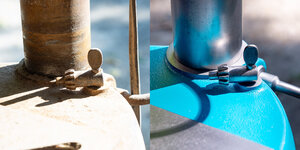

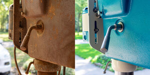

Well, folks, I can finally say I'm done. Well, ok, 99% done. I still need to recreate the badge, which was too far gone. I'll get around to that eventually. But the rest is finished. I am very happy with it!

Here are some shots of the motor progress. I wanted to try to preserve the label inside the cover, but unfortunately as I tried to clean it off, the print came right with it. If anyone has a good photo of the wiring diagram of that label, I could recreate it (I'm a graphic designer).
