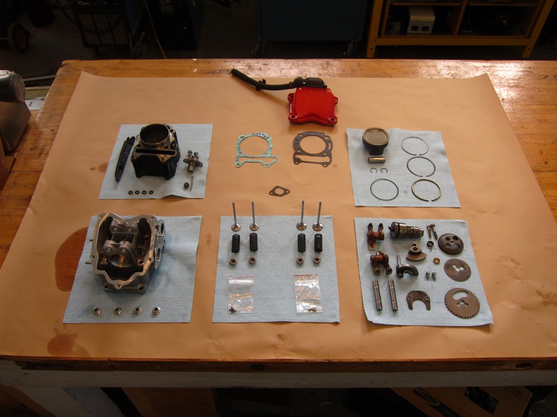

What brand of cylinder head is that, I have an old vespa i want to fix up one day.
The cylinder head is a Malossi V4 head, and only fits a narrow range of modern four-stroke Vespa engines. It's primarily for the Quasar engine range, found in the Vespa GTS250 and GTS300, plus a few assorted Piaggio bikes. Here, I'm fitting it to the 200cc Leader engine, which took some creative modification of the piston in order to allow clearance for the oversized valves.
Just to be clear, this cylinder head definitely will not fit older two-stroke Vespas. There are quite a few top end kits for those, though -- mostly from Malossi, Polini, and a few others. I'm not an expert in those kits, though. What kind of Vespa do you have? What era?

Here's a good representative picture of a 200cc top end during reassembly with a high performance cylinder head and modified piston.
50cc is a class of its own where I live(Holland, EU). We can drive them without a ''real'' drivers license so a lot of people have them. It ranges from vespa's to scooters, and 2 strokes(new and old, even liquid cooled two strokes).
Do I spot 2 cam shafts for that single cylinder by the way? Looks interesting!
I'd love to take one of those apart, keep the pics coming!(the garage and the mechanical bits:) )
