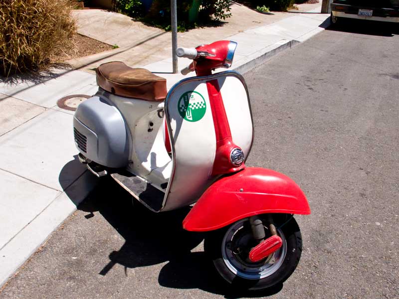

Here's mine, in a photo taken by the previous owner:
