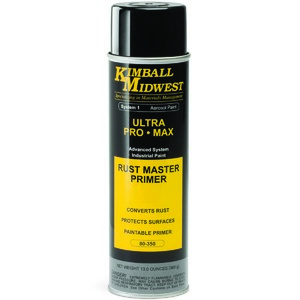

Go to you dollar store and get the spray on anti stick coating [generic pam] and spray that on. Dries to the touch and works as welding anti spatter also. Then still clean with WD and steel wool.
I use this at work. Goes on Clear and then dries black. Use it on my welding table and spray it on any bare steel that is starting to rust. I think Oshpo is about the same stuff
Thanks for the suggestions guys! Maybe I'll swing by The Woodsmith Shop this week and see what they have.

Concerning the coating on the steel top... while I genuinely appreciate all the suggestions, I suppose I should clarify that I'm not really all that worried about it. If I were only using it for woodworking or light duty tinkering, I would probably put wax, epoxy, or some other product on it. However, since I'm kind of into all sorts of stuff, I don't want to have to worry about something like an oily engine part ruining the wax job on my bench top. What I like about the WD40 route is that if I get it greasy or rusty or whatever, its nothing a little engine cleaner and a wire brush can't fix.
