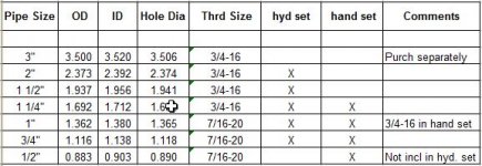

The difference is that the pipe sized Dies are made to fit the HF knock out punch size.The dies also have a matching thread in them so you can also use the Knock out mandrel to squeeze the dies together.
The standard size Dies have standard sizes starting at 1/2'' through to 3 1/2'' diameters in 1/4'' increments. These are made to be used regular hole saw hole size.They are also threaded for use with the Knock out punch.

Here are the dimensions of the HF pipe punch dies
Thank's for the chart Jim.

I've got some questions on this table (I'm probably just confused):
Maybe I'm just reading this wrong...
Pipe Size = 3"
OD = 3.500"
ID = 3.520"
Where I come from:
OD=Outside Diameter and
ID =Inside Diameter
Using that logic the inside diameter is larger than the outside diameter???? :dunno:
...and you end up with a 0.010" wall thickness????
Maybe I've got the wrong acronyms?

Ok, so maybe this is the best description. As on the web site.
Specifications
Sizes include: ½”Pipe = 0.890” Hole , ¾”Pipe =, 1.118” Hole , 1.0”Pipe = 1.118” Hole , 1 ¼”pipe = 1.692” Hole , 1 ½ “Pipe = 1.941” Hole, 2.0”Pipe = 2.374” Hole, 3.0" Pipe= 3.5'' Hole all with either a 7/16”-20 or ¾”-16 threaded Top Die.
Pipe Size = 3"
OD = 3.500"
ID = 3.520"
Where I come from:
ID =Inside Diameter
The OD is the OD of the HF punch and the ID is the ID of the HF die. The difference is the clearance of the punch in the die. The hole size is the diameter of the hole that the set produces. Sorry for the confusion
