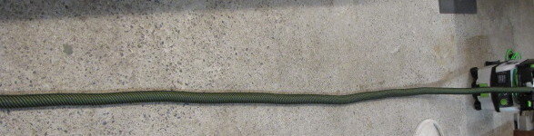

The smooth vac hoses make a big difference when you're dragging it over the edge of your plywood.
Unfortunately, the only ones I know about are Festool and the hose costs about the same as the Wen Saw with track!
Are there any other smooth vac hoses suitable for dragging behind saw?
Despite the price, I'd get the Festool again if I can't get a similarly performing hose for less.1736577158495.jpeg
Not positive but I believe there are hose wraps or sleeves similar to welding lead sleeves that will turn any ribbed hose into a smooth(er) hose
Someone should find and link 😁
