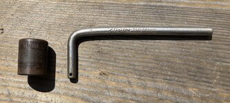

16,609
I found these two Blackhawk tools recently. The 13/16” socket rang a bell and I checked my old set and found a Hinsdale placeholder in the 13/16” hole which has now been replaced with the new socket. IMG_1709.jpegIMG_1707.jpegIMG_1716.jpeg
I noticed that I was short the correct 1/2” socket if anyone has a spare of this style.
i don’t know anything about the ell handle but would happily trade it for my missing 1/2” socket.
