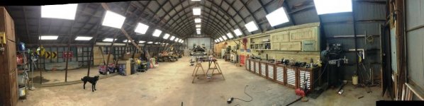

Something else I've been working on was the area to the left of the main door, it had gotten to the point where stuff was piled everywhere and it was difficult to do anything with any of it. Everything was a mess and it hurt me to look in that general direction. I didn't intend to clean as much of it as I did but that is how things went which is why I don't have a good before picture. I pulled everything out and took down the wood panneling:
I then cleaned the lean to area behind that and hung up some of my new to me signs:
I picked most of these up from another house we bought that had them stuffed in the shed out back. I'll add more at a later date but that is all of them I had in the shed at the time.
This is with it mostly cleaned up, I'm still trying to get rid of those old windows and doors but haven't had much luck so far:
A little wider view:
Lastly a pano of the entire shop, it looks huge in this shot, I also have the Hidey Hole Mascots keeping things lively:
In other good news I have the Warthog back together completely, I'll get it in to have an alignment done this week sometime then have some shakedown time before the Hot Rod Power Tour in June. :3gears:
JB

jabin
May 3, 2007
526
SW Ohio
Wow, it does look huge but it's amazing how quickly it feels small when they fill up with stuff.
Still love the wall and the lights! I'm stealing ideas. :D
J
jbmatth
Jun 3, 2013
5,694
Northern Ok.
It still feels big for now, but I really need to get some stuff knocked out to make room for a large project I want to do in the next few years. ;) Also steal away most of my ideas are probably stolen anyway.
Looks like a wind tunnel:lol: You could make a table out of those wooden doors?
No wind tunnels for me, I have a hard enough time keeping the dust down with all of the air leaks in this place. I might be able to do that, I have a lot of other cleaning I need to do.
i think i am jealous. also think it is looking great!:rocker:
jim
You think your jealous and I'm outright jealous of space he has. I can only dream of that much shop space.
Thank you all so much for the kind words, I really appreciate it all. I have spent a lot of time out there working on it lately and have lots of updates to get to, hopefully I'll get to it shortly.
