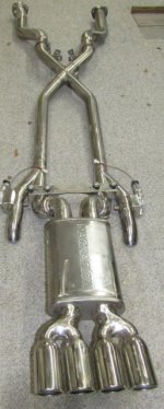

I do have a few updates, I'm not sure but I seem to have stalled out some, I'm staying busy but don't seem to make much photo worthy progress. Anyway I installed the power steering pump pulley and can confirm the 300-202 pulley does fit and lines up with the crank pulley. However I had to push it on farther than normal and also had to cut the end of the pump shaft a little shorter to be able to remove the pulley to install the braided stainless line I also made:
View media item 80962
I received the wiring harness and it is slick, so far no complaints and it has fit really well:
View media item 80961
I have waited to install the starter until I got the wiring harness in because the crank position sensor connection is behind it. Well then the starter wouldn't fit unless I pulled the engine up about 2". 4 hours and $165 later I had a new starter installed. I broke the original starter trying to install it, yes I'm an idiot don't judge me. :lol_hitti
The only thing keeping me from dropping the body right now is the exhaust, it will be very difficult to install the exhaust once the body is installed so I decided to make it and install some V-band connections so I can remove it much easier if the need arises down the road. They should be delivered today if USPS wasn't closed. :( It is getting closer and I'm really getting excited to hear it running.

If you want to advance to a leadership role in the Idiots Club, you are going to need to step up your exhaust work. Doing it while the body is off is almost a disqualifier by itself but hopefully you can make the system as complicated as possible -- for no good reason. Start off with a bolt-on system.
Get rid of the two mufflers but save the tips. Get a single small dual-in/dual-out muffler and slap those tips on one end and a couple of v-bands on the other. Make your own header adapters from 3-inch u-bends, 2.5-inch adapters and more v-band clamps. Don't forget a pair of electric cutouts. Now that's what a post-graduate idiot does.

What are your plans for the exhaust? A single 3" system will flow every bit what you need.

That exhaust system is a thing of beauty, and well over complicated compared to the kit you could have bolted in, I salute you!

I'm running from the headers to 2.5" collectors, a section of pipe to go horizontal, V band, flex joint, straight pipe, flowmaster 10 series mufflers, then dumping it from there. I want to hear what the exhaust sounds like without a crossover, if I don't like it I can always add one later.
