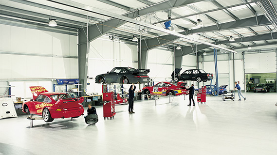

Never again. My last employer built a new shop and the owner was enamored with the white epoxy floor. It's a horrible work surface. A light oil or coolant spill is invisible and becomes super slippery. I'm kinda surprised nobody had a serious fall.
It does look good and the reflective light is nice, but it's also fragile and slick.
Any smooth floor is dangerous when wet. Your employer should have added some non-skid to the final coat.

That brings up the question of how slippery is your floor?
I have a brand new floor, no stains, and I like white, but I cannot afford slips and falls.

Kbs, not slippery at all. Even after grinding, my rather old floor has lots of surface irregularities. If your floor is very smooth now, you may want to add some non-skid to your final coat.
The Increte stain sealer is 45% solids, so even after 3 coats, deeper pits etc are sealed, but not filled. It's therefore quite fine wet. A 100% solids epoxy would likely completely fill the floor, so would definitely require some care with regard to wet traction.

This pictures from Aston Martin One 77 production plant was my inspiration.

and which white did you choose? the Porsche or the BMW white? (RAL9016 or 9010?)
despite this, nice!
I went with the same white as in the Aston Martin One 77 plant. It's called "Becker's White" which does not have a RAL color code but the closest is 9016 Traffic White.
The only down side is they charge a fixed "non-standard color" surcharge which is acceptable if you order a lot at one time but too much if you want to add only one piece later on.
