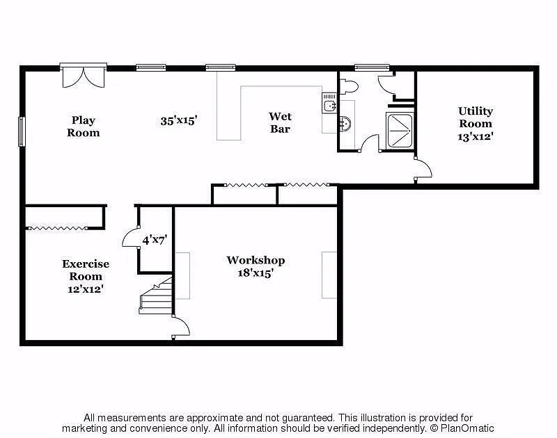

We moved into a new (to us) house with a nicely sized workshop in the basement. PO left me a ShopSmith table saw, router/router table, dust collector, air compressor, some other goodies.
The shop has no outside ventilation. The walls are either below grade or interior. The rest of the basement is finished, and much is above grade (sloping lot).
I've been doing some woodworking and while the DC is helpful, I'd like to get some air flow in/out of the shop. Mostly out. I don't really have good access to run a duct from the workshop to the outside..only real option is to run it to the left through the closet. But the closet is finished and I don't really want to do too much exploring there.
Garage is to the right, one floor up.
Then I thought...I don't need a *permanent* duct. I don't do a *lot* of woodworking, just occasionally on weekends. The workshop is also my bike shop and I occasionally use citrus based solvent for cleaning bicycle parts. So far, anything that requires more ventilation (hardwood cutting/sanding, staining/polyurethaning) gets moved to the two bay garage with doors open...
I could go through the closet and run a flexible vent down the hall, into the utility room and out the back wall there. When I need ventilation, I hook up the vent. When I'm done, I disconnect the vent and coil it up in the utility room.
Now that I've written it out, it feels like a permanent vent out to the left is a better option. There's already a boxed in chase leading from the workshop to the closet. It would certainly be a more elegant approach...
Location is New England, btw.
What size vent should I use? What's a good source of fans for this application? Do I need to filter the exhaust?
Right now, the DC is in the top right corner. Do I want it to be close to the vent inlet?
Comments appreciated...

Thanks guys, as mentioned above I do have a data collector in the shop, a ShopSmith DC3300. I just ordered a new tall hood for it, as the current (small) hood looks to be pretty well used. The tall hood supposedly filters down to 1 micron in particle size. I also ordered a couple of new hoses as the original ones are pretty well worn and kinked.
That's a first step. The second step is to do better dust management at the individual tool, the Shopsmith saw, my miter saw, etc. I'll see how much these two steps affect the airborne dust (and I do wear a KN95 mask when I'm generating dust). My concern is that it will linger after I'm done cutting...and have turned off the DC, and removed my mask.
I do think an outside exhaust will be helpful due to the air turnover, am wondering how to best make that happen...

One suggestion is to add an air scrubber to clean the air in the workshop. Several of the major brands make a version and you can build your own with an old furnace fan, plywood and filters; or even a box fan and some furnace filters bungeed on. Most of the brands even have a timer so you can set the cleaner to run after you finish working and capture the suspended dust that the dust collection misses.
What type of ceiling is in the rooms you show on your floorplan? Also, what are your exterior walls made of?

This product that ShowKey linked is your best solution, imo.
The finest dust collection system with 20hp motor can't capture all of the fines from tablesaw or mitersaw blades in my opinion. You have to have the recirculating filter to get those fines incrementally over time.
The big downside of outside air is a) its one half of a heat leak in your house -- as soon as a door is opened and b) its a wide open invitation to get humid air in the basement which is murder on bare steel and iron surfaces so commonly used in woodworking equipment. It also affects the actual wood -- your hard won precisely dimensioned S4S is suddenly a cupped banana board.
Interesting. Hadn't thought of that.
In the shop, two walls are poured concrete, the other two are 2x4. All are fully covered with pegboard. The ceiling is unfinished, with joists showing and fiberglass insulation batts, paper facing down.
Other exterior walls are either poured concrete or 2x4 (6?), all insulated and covered with drywall. Ceilings in the spaces other than the shop and the utility room are finished (drywall). Eyes are blue. :)

Thanks, I appreciate the input. I am concerned about the "make-up" air if I go with an exhaust approach. Our house is pretty tight already, so tight in fact that MassSave wouldn't sign off on top sealing our attic or adding any more insulation until we put in an HRV. (They first suggested that we just run a bathroom fan 24x7). Several appliances in the house want air -- NG boiler, cooktop and clothes dryer, and a wood stove.
I'll take a look at that self contained filtration system. It sure might be the easiest, and potentially the most effective.
The length of the duct (whether you use this method or install something permanent) needs to be taken into account when sizing the fan - the longer it is, the more friction loss there will be.

If you are looking right at your joists why not a 6 in hole through the end joist? The way most houses are framed the entire bottom wall (in your diagram) of your workshop is available for a duct exit. I have recently started looking into managing dust in my garage. First step was to make a few adapters on the outlets of bandsaws and sander so my shop vac will easily connect. But I notice the internal design of those outlets isn't much at all, so I am going to start sealing the bottom housings w/ sticky back weatherstrip. Thinking to seal as well as possible but leave some opening at the far side from where the vac attaches. I 'think' that might get me better flow though the machine so more of the dust is sucked out.

If you're going to discharge the DC out of doors, keep in mind that you could reverse draft your furnace or water heater.... you will need make up air... and as you know, that will be cold 2/3 of the year.
Yes, this is a concern. May be enough of a concern to nix the idea of an outdoor exhaust. I've also thought about providing outdoor air directly to the NG boiler.
The indoor air scrubber looks like the way to go...

Quick update... I ordered the big filter hood for my ShopSmith dust collector...needed to do that as the one on the unit is *old*. And a couple of new collection hoses as the old ones were badly crimped.
And I ordered two of the small Wen air filtration units. i was going to order one large one (1000 CFM max), and then figured that two (400cfm each), placed at opposite corners of the shop would give me better air circulation in the shop and therefore more net filtration. Overall price was about the same.
Now I have rewire the shop...the PO, bless him, wired the entire shop on one circuit, and running anything more than the ShopSmith table saw and the DC will blow the circuit, leaving me in the dark. I assume that the addition of the Wen(s) to that circuit is a non-starter!
+1.
Is your basement all the way to the ceiling below grade. The absolute best solution from a health standpoint is to eject all the exhaust of the dust collector outside. Yes it uses more heating/cooling energy but no issues with fines getting circulated over and over in the shop. They chips and big dust can be collected using a cyclone or thein baffle. I personally use two 797 truck filters. Much cheaper for the same filter that is sold as "hepa dust collector filters"
The air purifier is still probably a good idea to run for a couple hours after running machines. I wonder about how "true" the specs are on those Chinese filters" Some of the other hepa filters they make are no where near their advertised specs.

+1.
Not really an option. One wall is below grade against the front of the house, the second is below grade against the garage pad. The other two walls are both interior.
Not possible to exhaust to the front of the house, or into/through the garage.
I could potentially run a duct out to the left side of the house through a closet, but that would be a 15 foot run, and I'd need to provide make up air. Might be a good supplement to the air filtration system. I'll have to do some exploration (with a drill...) :)
