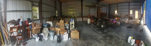

The weather finally cooperated and I was able to get the exterior "done".
It needs some more screws and the trim along the front eave needs to be reattached but I'm ready to move in!
I pressure washed the entire floor about 5 times with various attachments, soaps, scrubbing, etc. to try and get all the red clay stains off that were ground in by the scissor lift wheels. I got it about 80% and decided the work outweighed the benefit for a working garage and it chocked it up to character in the floor. I really like how splotchy it is front the power trowel with the darker and lighter areas. Here's the before
I laid down some Ghostshield 4500 densifier which I failed to get photos of but here's the floor already treated with it while I set up for the sealer. I went pretty heavy with the 4500 (it went much farther than anticipated and I wanted to use it up) so there was some crystallization/residue that had to be scrubbed off
I had a helper for the scrubbing
But she wore out quickly and needed a break until momma got home to watch her
Fuzzy pic of the floor 2/3 through sealing. This also went much further than anticipated, I only used about 3.5 gallons and the backpack still had a bit left over. I hit a few spots again that soaked up quickly but the sealer was beading up on the surface which means the slab took about all it could handle. Felt bad dumping what was already in the sprayer so I figured I'd see what it does to the wood on the trailer deck since that's almost shot and the trailer was sitting there. Guess I'll have to come up with a use for the rest of the sealer before it goes bad
Today is the start of move in day and a dumpster/dump run is in my near future for clean up of all the debris around the building. Then landscaping to prevent mud from splashing everywhere, electrical, wall sheathing, and a million other things which I'm sure will never end

Started moving in a few things last night, at which point the floor had been treated about 22hrs prior. The fridge had some residual water which dripped out along with a bit up mud on the dolly wheels that I decided to let sit as a test. The mud (now dry) brushed right off this morning and the water that hadn't evaporated was still beaded up this morning. Very impressed with performance especially for how easy this was to install
