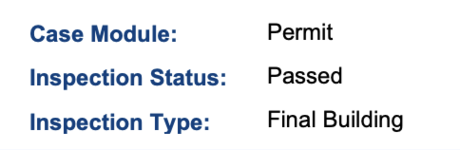

Time for a big ole fat daddy update!
We passed the electrical inspection last week and they should be running from our transformer to the 2 x 200A panels in the next few days. Spent last weekend doing a bunch of landscaping and grading (seriously, if you don't buy a tractor with a loader when putting up a building you are shooting yourself in the foot later) and spreading more straw than I've ever moved in my life. I was finding that **** in my shoes for days. This past weekend we fixed the person doors and installed all the roll up doors. All we should have left for the 'certificate of completion' is to seed/straw all of the exposed disturbed red dirt and fix the trim around the one person door off that concrete driveway and I think we'll be good.
To quote Clark Griswald Sr 'she's a beaut'.

Friday will be one year since I signed the paperwork on buying the land. To go from buying to moving in in almost exactly a year apparently is absolutely unheard of.
