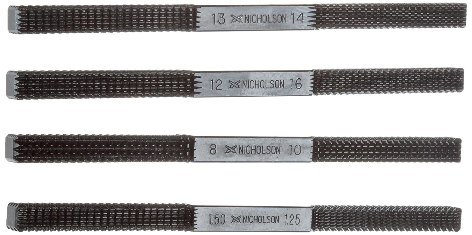

Nicholson Thread file set, 4 pc, from Amazon, $56, free shipping.
http://www.amazon.com/dp/B001T4KRHC/?tag=atomicindus08-20
Well worth having.
Color caps on tubes Type 1 black cap: Regular bolt; 11-12, 13-14, 16-18, 20-24 TPI Type 2 red cap: Ex. Fine/ex. Coarse bolt; 9-10, 12-16, 20-27, 28-32 TPI Type 7 green cap: Regular pipe; 8-10, 11-1/2-14, 16-18, 24-27 TPI Type 8 blue cap: Metric Bolt;. 75-1.0, 1.25-1.5, 1.75-2.0, 2.5-3.0.

Pardon my ignorance, but how do you use these ?
Charles (in GA)
Jan 11, 2006
12,489
50 mi south of Atlanta
These are used on male threads on bolts and studs. Say someone started to cross thread a nut on a oddball bolt that you cannot get and you need to reinstall it. You select the proper file based on thread pitch (For example ½-13 thread) which is the top file in the pic, the LH side of it, the face that is showing, marked 13. You simply file the threads to remove the burrs and clean up the threads so the nut will smoothly spin on. Each file has a total of 8 different thread pitches on it and some are metric, some fractional. Its really quite simple.
YOUTUBE video on using a thread file.
Slightly better video on doing this.

WTH in the 2nd video link? The guy says he finds 27 tpi on the leaf gage and then correlates that to "one oh," so it sounds like he's using a fractional thread pitch gage and metric thread file.
It may work, but not recommended folks. Get a metric thread pitch gage if checking metric threads. Available on Amazon when you order your thread file.
1.0 should be 25.4 tpi, so a 27 couldn't have fit perfectly if he was looking closely.
