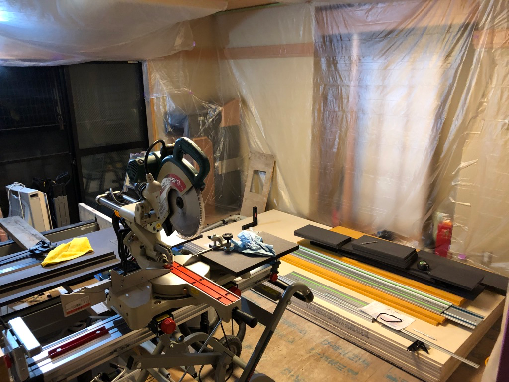

I got some "colored" MDF that is sourced from Germany to build my assembly/router table. I will be doing the whole MFT/20 hole pattern deal with it. (Workbench Drawing v5.pdf) It's going to be a lot heavier than I was hoping for, but fingers crossed that it will last and be useful over the long haul. One thing I will mention is that I've been using my ridiculously cheap (under$200) Ender 3 Chinese 3d printer to create precision router templates, and if you have the need to do super accurate routing you should really take a look.
In the foreground is a domestic market Hitachi mitre saw. I usually go Makita, but the units offered domestically are years behind the US models and as with everything here in Japan only used by professionals, super overpriced. The Festool is around $3k here so, no way I'm doing that... most of the units sold here are 165mm because they do not do the same sort of construction here, western 2-by is really uncommon. I went with the 10" since I have a bad habit of being frugal then remorsefully and begrudgingly buying the thing I wanted and ending up with 2...
It is sitting on a Bosch cart that I had shipped over from the US. They do not sell these wheeled miter saw stands here at any price, and I was thinking I was being so clever, was going to use a first floor closet, just wheel her out when needed. When I finished assembling the thing I quickly realized that it was so massive that it literally cannot fit through any of my doorways and had no chance of fitting in a closet, even with the saw removed, not even close... It may not even be able narrow enough to be wheeled through the narrow walkway to access the rear of my house where storage could conceivably be built to store it. Problem for another day, but just want to share my pain with you lucky bastards with enclosed garages...

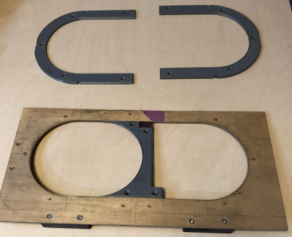

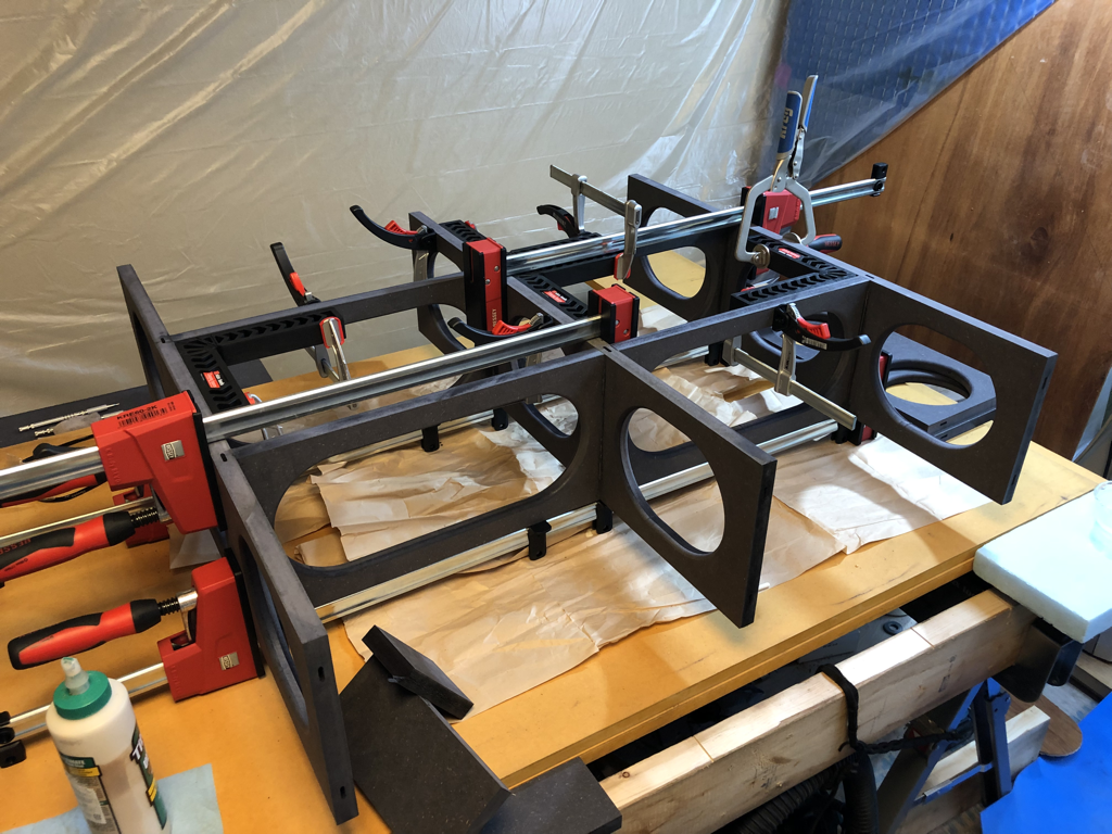

Waiting for my first glue-up on the worktable to set. I wanted to cover the 3d printed router templates a bit, since I think they are something that can really save a ton of effort. My 3d printer is relatively small, so it wasn't practical to print out the entire template. Given I had 3 different, but similar profiles, making it in several pieces wasn't a disadvantage anyway. I had a lot of scrap 5.5mm plywood sheathing, and made the templates with registration marks so that I could screw them directly to a section of it. I used a standard pattern bit with a bearing to directly transfer the profile to the plywood, so I could have a single piece. I mounted two small blocks to the bottom to register the template and provide a clamping surface. The extruded insert seen taped to the plywood template allowed me to model the smaller two "slot" profiles used in the worktable struts.
When making a template you need to account for the hole or pattern you are making, and calculate the offset using the bit radius and the diameter of the router "guide bushing" being used. The formula for the offset of an internal template like I am using here is: (Guide Bushing diameter - Bit diameter) / 2 and once you have the offset, it is pretty trivial to plug that into the "offset tool" of a Fusion 3D sketch to create the correct pattern for whatever it is you are trying to cut. The tolerances I'm getting are fractions of a mm over quite a distance, I think very complex inlays or signage are quite workable, so keep it in mind if you don't have a wood CNC.
Using the Festool Domino for the first time, it is really precise and FAST. The little paddles on the sides allow quick registration that ensures the parts line up without any drama. Highly recommend it! I originally intended to use pocket screws to tie everything together while the glue did its thing, but my tests showed that they badly interacted with the MDF causing delamination and puckering at the entry preventing a tight seam. They would have required pre-drilling of the second surface (Kreg should make a bit with a longer minor bore!), so just glue and dominoes are the prescription for the table. Fortunately more Bessey clamps were delivered today, so I could get most of the guts glued up.

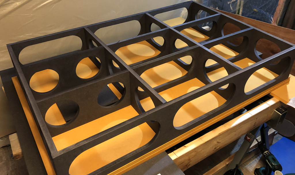

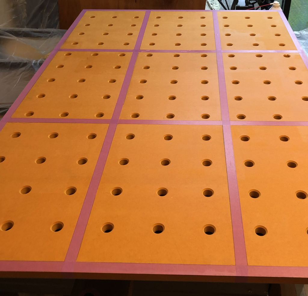

Back at home my uncompleted workbench was waiting for me. I had completed the frame and glued and dominoed the bottom.
I then sealed it and applied two coats of water based poly using a domestic Japanese brand (Washin-Chemical) that worked pretty well (based on my extremely limited experience.) It is difficult when you can't tap into the reams of product feedback and testimonials available in western countries to identify good products. :(
Sanding in all those complex compartments between coats was a chore, but my Makita Multitool with the little Trigon sanding pad fitted to it saved my bacon. I hope you have one, just don't forget that you have that in your arsenal.

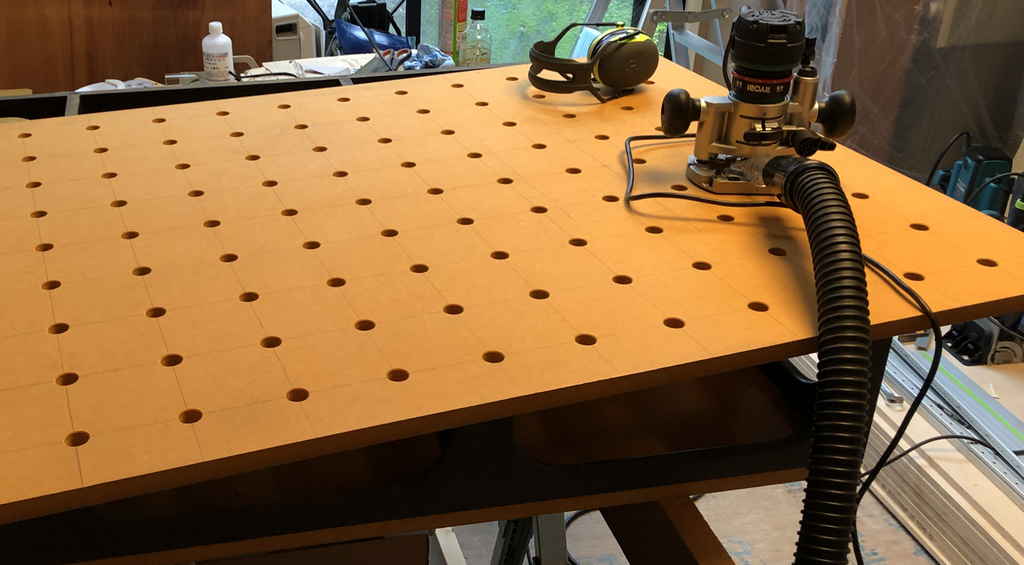

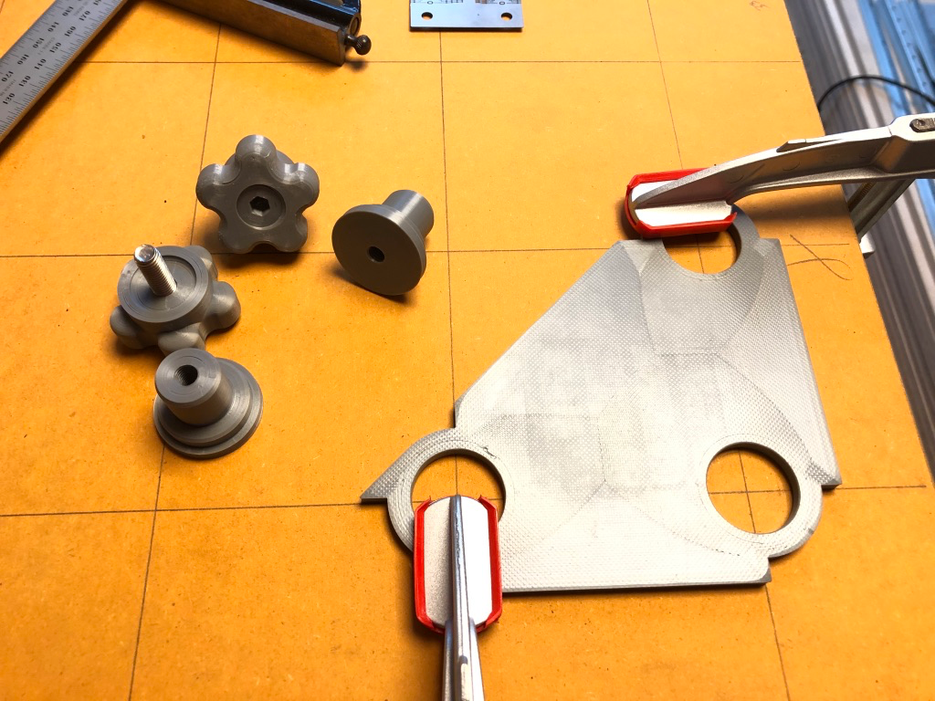

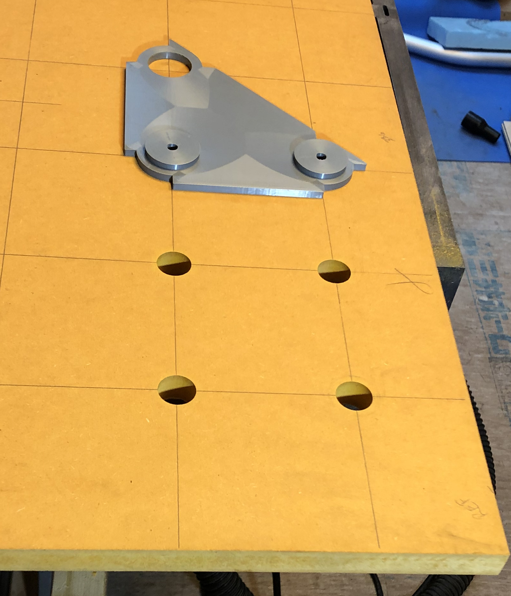

I had 3D printed out some items to help create the MFT 20mm hole pattern for the top of the bench. Basically 20mm dogs with a 30mm top and a little rim to clamp down the template. The template has three 30mm holes that were modeled 96mm center to center, with cutouts to make sure everything was centered and aligned.
My thinking behind only having 3 holes was that the dimensional error would propagate evenly on both axis, but it meant tediously moving it for every hole. Despite it being off 96mm from center to center by only 0.1mm, this propagated out to about 2mm total by the end of the bench, although it is square at least which was the real concern.
I had carefully scribed all the center points, although I knew it would drift, I just wanted a sanity check. You can see how the last of the holes is several mm off from the lines. If I were to do it again I think I might reprint it with more "slop" in the hold downs and manually center the hole to the carefully scribed lines each time. I would also start from the center of the work surface instead of a corner so that any error was more evenly centered. Still, this was far cheaper at about $50 for a 20mm straight cut router bit and 30mm Guide Bushing than the $300 Parf-Guide System which is not available here anyway. The number one thing for these holes is that they are square in X & Y, and my measurements show that they are very accurate in that respect, so I'm good with it. Letting go of perfect is hard, I was really tempted to try and compensate for the deviation that I could see accumulating, but I think I made the correct call as it would have been easy to introduce more variability instead of a consistent amount of error.
I was worried that there would be a lot of horrific blowout on the opposite side of the hole since it was a big bit under a lot of force in my heavy plunge router. Not that it would be visible inside the box section, but I would know. Fortunately there was just a small bit of ragged edge that was easily removed when I chamfered the bottom sides. Those reliefs are intended to help through clamps insert a bit easier. I put really small chamfers on the top surface of the holes as well, then I taped up the glue lines on the bottom so that it would have a raw surface to join. I then sealed the bottom and have started with the poly coats. I want to minimize the amount of work I need to do inside that thing once the top is glued on, by pre-finishing this I can just run a bit of poly in the inside corners and be confident that it is nice and stable.
I'll put another coat of poly on in a few hours, then remove the tape, carefully transfer and pocket out the domino locations and glue the top on to the frame and bottom (after shimming that on the sawhorses to ensure it is true and level.) Then I will need to flush trim the top and bottom, sand and chamfer all the outside surfaces. Seal and poly it, and route out the router plate hole and bottom clearance port.
This thing weighs a ton by the way. I was picturing a super light, spidery truss workbench that I could toss about, but 19mm MDF clearly isn't the right choice as far as weight is concerned. I will have to mount some casters on one end or some kind of detachable dolly :(

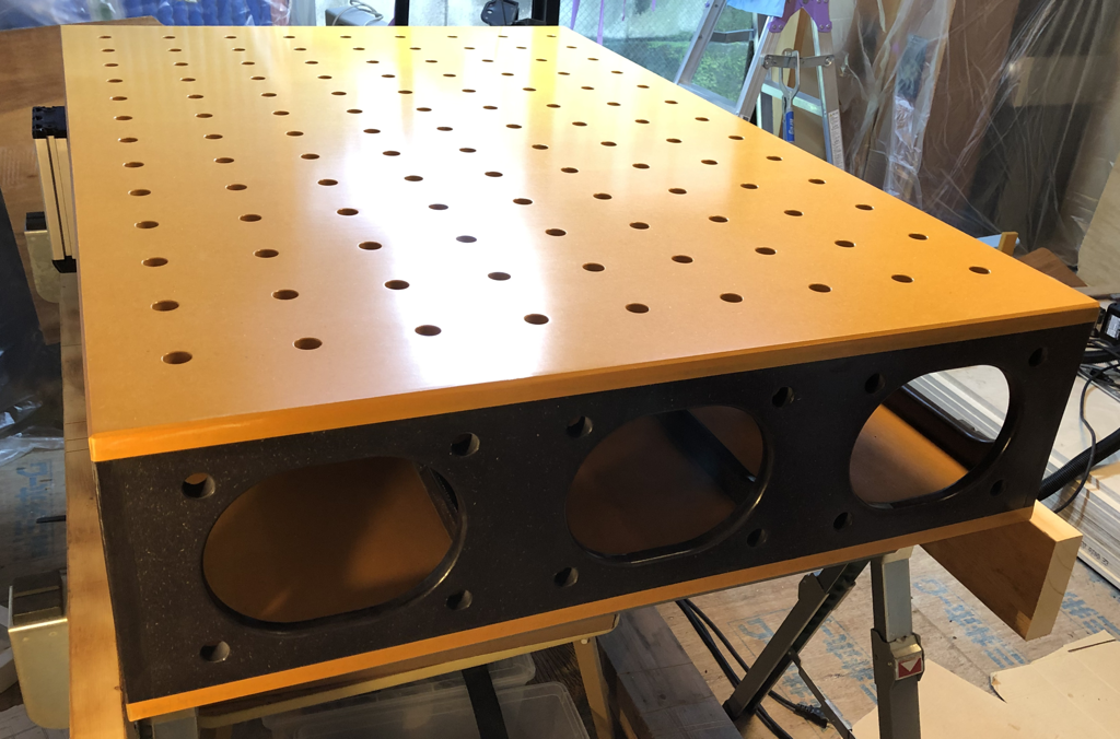

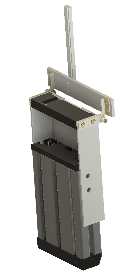

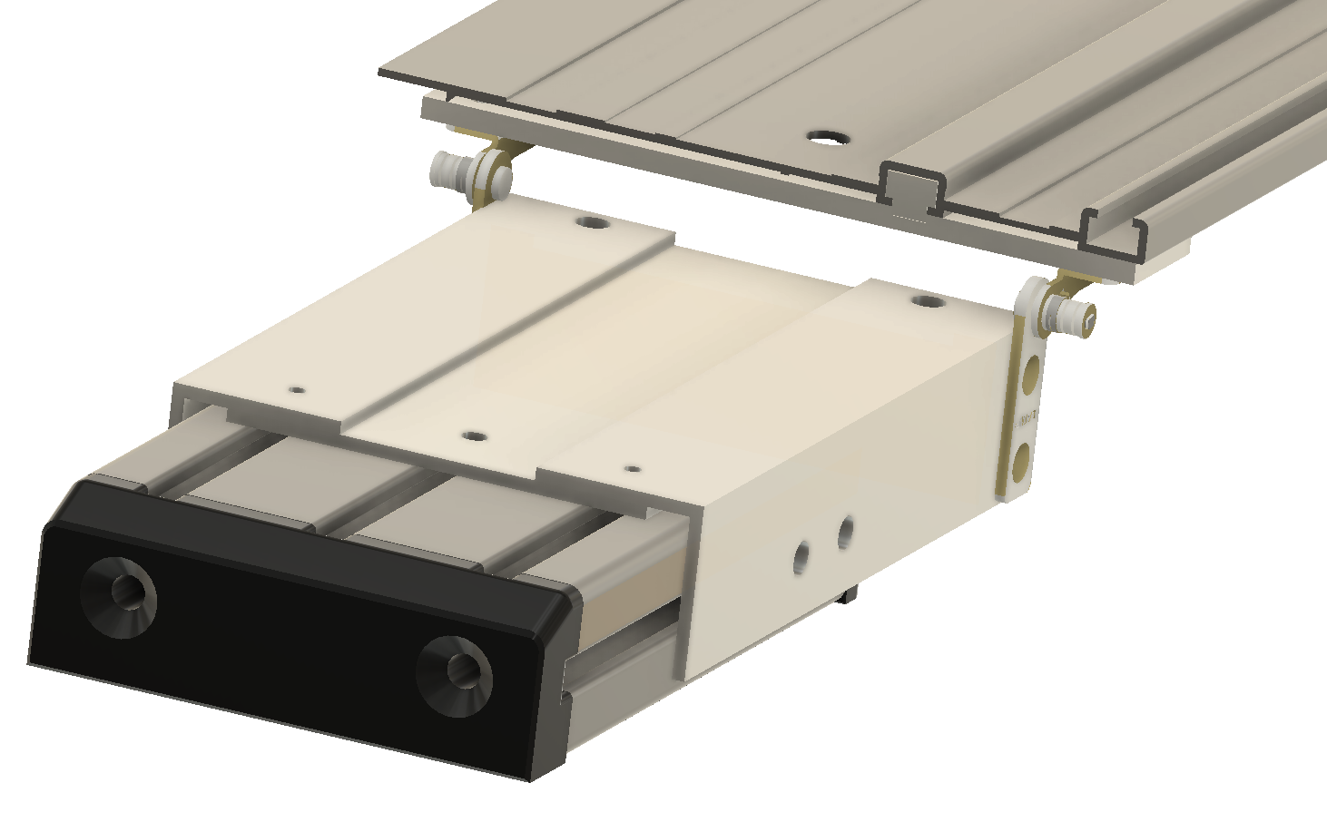

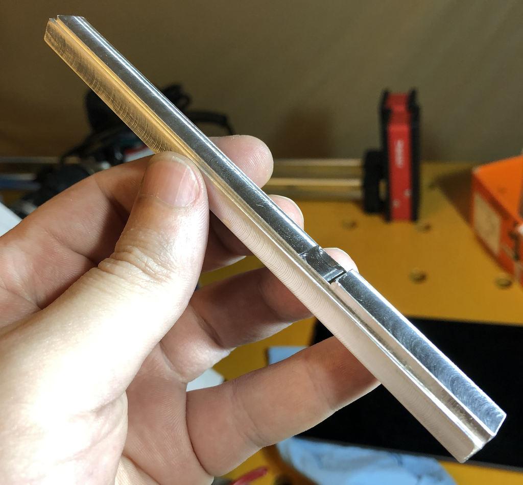

I think many makers suffer from being constantly torn between the tools of their craft and the product of their toils. I have not mastered the ability to march forward towards progress when there is a new tool to be found, made or improved somehow. I find myself spending hours optimizing something I'm likely to use a handful of times, saving maybe a few seconds in actual use... but maybe that's what being a craftsman means? Anyway, after many weeks the table I will (theoretically) use to build the cabinets is basically complete.
It's not really finished, there are several attachments I am in the final stages of design/production for, but as far as it being a complete table in and of itself, it is indeed functional as such. I will note that my color balance isn't way off, this is special German colored MDF and it is really a rich Curry Yellow. My intent was to color coordinate with some of the Incra gear, give the table a bit of pop.

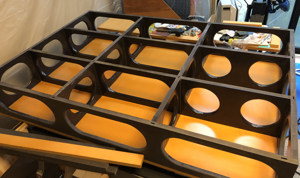

As I mentioned, all the internal baffles were fillet and given several coats of poly. I wanted to make sure this thing doesn't sponge up moisture and warp on me. The top was then glued on and all the externals went through the same, 120 grit sanding, sealer, then 3 coats of water based poly with 400 grit sanding between layers. I wanted to get some practice on applying a clean poly finish on large surfaces, I'm feeling confident that I can do a passable job with foam brushes. I do have a Graco airless sprayer that would likely get this perfect in two passes but I'm a bit intimidated by the amount of work involved. I'm very space constrained and I feel like it only makes sense to break it all out if I'm able to spray multiple cabinets and panels at once. I will continue to ponder it.
I decided not to mount my router plate directly in the table itself as my original design outlayed. It was a really tight fit (my fault) and required holes in both the top and bottom surfaces for clearance which just felt ugly to me. I realized that making dog holes on the side panels and making auxiliary tables made more sense. So the router table will bolt on when needed. This also makes putting in several T-slots less fraught as I can much easier rebuild the aux table if I mess up or it displeases me. Because I used the same base 32 spacing on the side holes the auxiliary table(s?) will be able to attach to any side with either top (perforated) or bottom (solid) surfaces oriented up.

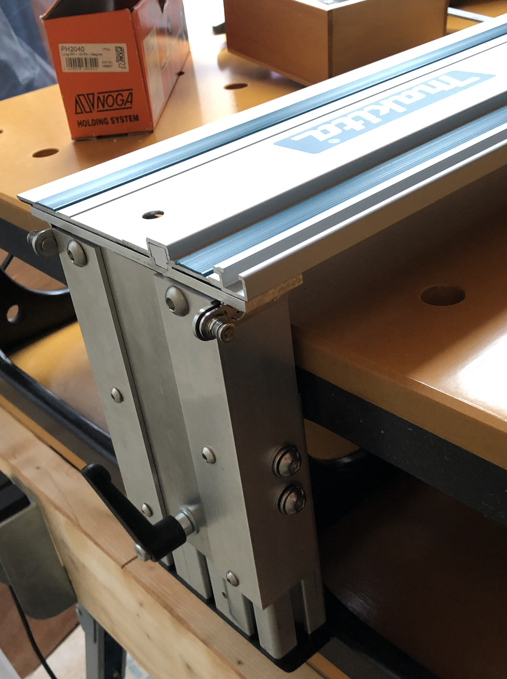

Also utilizing those new holes on the sides will be the track saw arm, made from some 40X120 extruded aluminum I had laying about, custom 3D printed parts and various bits and bobs. You can see the base of one of them attached to the side there, I will detail it once it is all fabricated.

Love the dog holes in the sides of the bench, looking forward to seeing how you use those in more detail. I had the thought to do the same on my (much uglier) homemade MFT but I didn't plan for it and there's not enough room. Gives you some nice vertical clamping options, too.

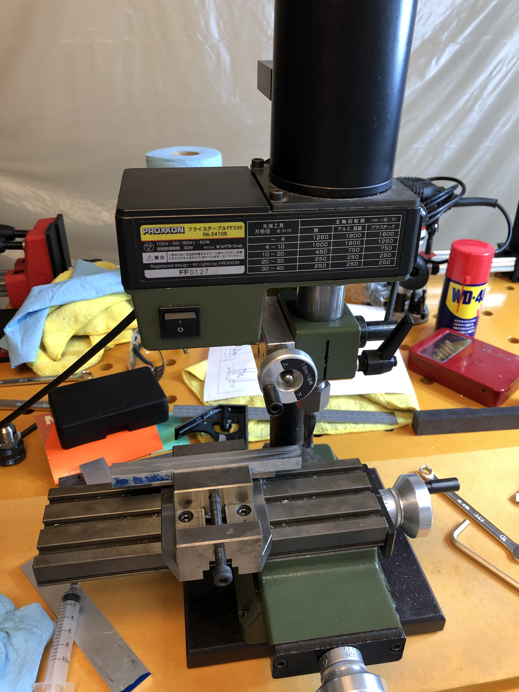

I'm still working on the MFT style track arm. I put the aluminum cutting blade on the Hitachi miter saw and pulled out the Proxxon FF230 micro-mill to machine some of the more critical parts and drill holes in the various Aluminum plate and angle parts I will use. This unit needs some love, I bought it third hand and have got it back into working order, but it needs new gibs, some digital scales, new cross-slide nuts, etc... But with a lot of patience, soft aluminum and a high tolerance for low tolerances you can make a small mound of man glitter and a half decent part.
This part was machined to friction fit into the lower t-slot of the Makita 1M track I bought for the table. Even though the Makita and Festool tracks are "compatible" there are minor dimensional differences, so this will not work with a festool track without some additional clearancing. But the Makita tracks are way cheaper and easily available (although they just started selling them over here in Japan, we lag way behind on many fronts, there are a lot of Makita tools not available here...)
It is swelteringly hot and humid here in Tokyo right now which makes woking extremely unpleasant. I'm using the air conditioner's circuit for my power tools, so there is no reprieve, just sweating my way through it.
B
Bakafish
Feb 7, 2017
478
Tokyo
I took photos of the parts as I assembled them, but it doesn't really capture the details. So I'm showing a few renders of the components as I drafted them in Autodesk Fusion 3D.
The two big 120x40 extrusion blocks were awkwardly screwed to the bottom of my mini-milling machine as a base when I bought it. They were filled with years of congealed oil and metal shavings and did little to improve the stability so I removed them during the cleanup. But they were a good fit for forming the basis of my MFT arm. I bought 2 friction hinges, hoping they would be stiff enough to make the guide rail more manageable, but they don't really do much until the rail is close to vertical. Ideally there would be a spring assist of some kind, but that's just my overengineering instinct, it really won't be a factor in use I think.
I used factory made fixtures designed for this extrusion profile for all the internals. There is a double nut plate that rides in the sides and a sliding friction nut and handle in the middle to clamp it at whatever height I need. The part I machined slides tightly into the guide rail which gets pinched tightly to the hinge plate. This seems to work well with very little play or stress on the joint.
I need to make the other side of the support where the front of the rail rests, which will (hopefully) be much simpler as there is no hinge involved.
