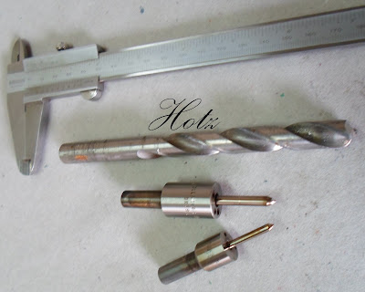

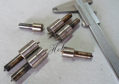

Hotz
May 16, 2010
135
south Brazil
Re: Tips & Tricks
When I built my rotisserie, I used 1/4" wall square tubing (actually .22) which gives a slight clearance except for the welded seam down the inside. I had to make a tool to remove this weld for the various pieces to be able to telescope inside each other. My solution was to Tig a 1/4 diameter rod to the end of my cutoff wheel arbor. Got it right the first time, no wobble at all. Added a cheap 1/4" id bearing to the rod (not shown in picture) to be able to slide the bearing where needed, & apply pressure to the weld without the rotating rod burning your hand.
Works well for accessing those hard to reach areas
the rod vibrates (oscillates) very?
