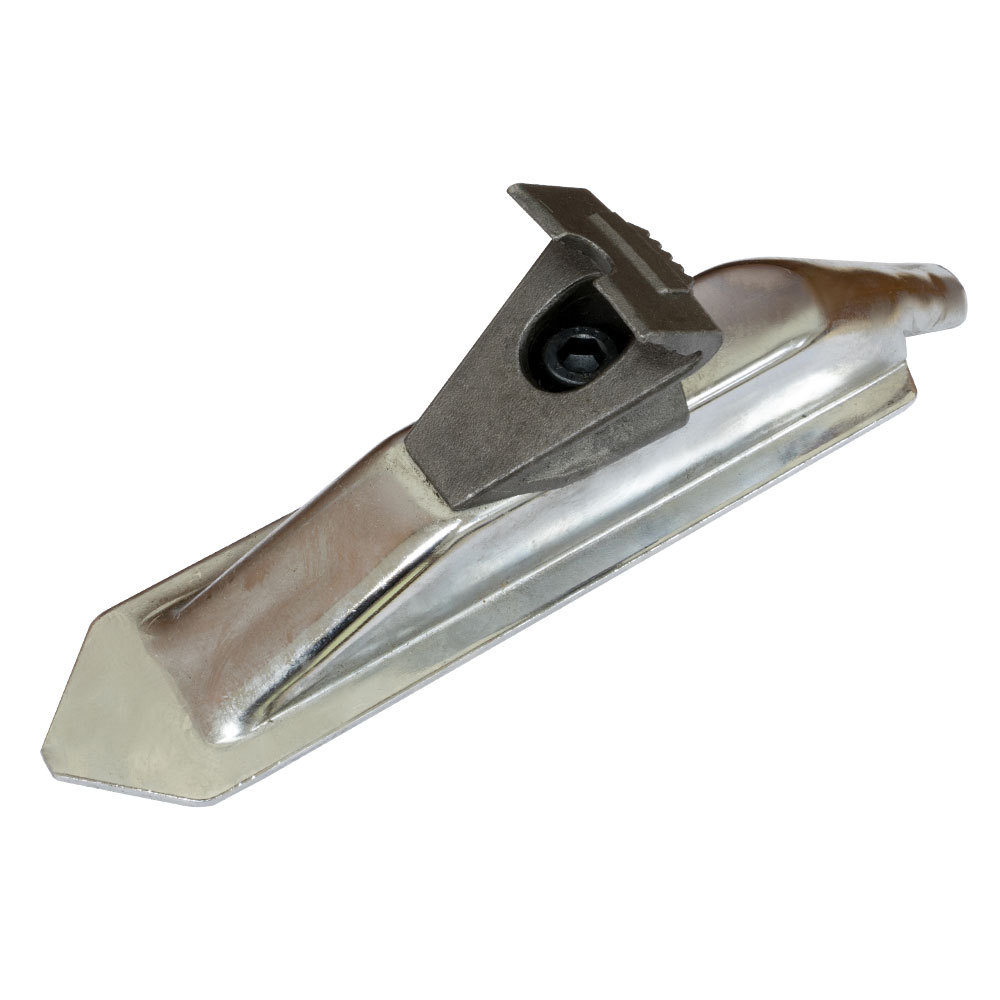

Hi everyone,
I just acquired a used electric/pneumatic tire changer for a good price. Being that I'm new to this tool/machine and didn't know what to look for and what to look at, I didn't realize that it's a motorcycle tire changer. It doesn't have a brand but from my research, it looks like it's a K&L MC680(or a copy of) tire changer since the base plate assembly looks the same. It just doesn't have the power arm.
I bought this thinking that it was a car tire changer and was gonna use it for changing car tires.
My question to you guys is that can I still use this for mounting/dismounting car tires? If not, is there a way I can convert it for use on car tires?
Attached is a picture of the turn table/base plate assembly (set up for motorcycle rims/tires)
Any help/suggestion/insight would be greatly appreciated!

Not sure how that works. Do the clamps move in and out with air pressure? It looks like they might be stationary.
If they do move in and out, then the only difference is they are raised up off the table. You could use them in the outermost position, or get some clamp brackets that are closer to the table - that will give you more room under the mount/demount arm to work with.

Yes. The 4 pieces on top of the base plate moves/slides in and out with air pressure. Pretty much all the car tire machines I've seen from research don't have those bars that looks like its laying on the plate but instead they have some ramp kinda thing and a claw type assembly like THIS.

Ok, so yours has the claws up in the air, because on a motorcycle wheel, the axle can stick out beyond the level of the rim edge. As long as the claws open wide enough for a car tire, you should be OK to use it as is.
I bet there is a set of claws that sit lower to the table. You may run out of room between the top of the rim and the mount/demount swing assembly with the raised jaws and a car rim. My changer looks just like the one you linked to, but has an optional set of jaws that are raised up for motorcycle tires.
You mentioned the "ramp" - that's not critical to the jaws - just used to hold the wheel up so the jaws align properly as they are closed. It looks also like those jaws on your machine are plastic - that's so they don't mar the finish on the rim - I assume they will be strong enough to clamp a car rim, but maybe not.
I would assume the mount/demount head is the same.

Sweet. I think I get what you're saying. So basically from the looks of it, it will work with car tire use. The rim will only be raised, which means I may not be able to do wide rim/tires.
So when would you use the ones that hold the inside of the rim VS the outside lip of the rim? I'm assuming you'd use the claw that holds the rim from the outside lip if you have a nice rim that you don't want to scratch, cuz its usually padded/guarded?

Yeah, I think it should work - unless for some reason the mount/demount head is smaller or weaker - but large motorcycle tires have sidewalls that are just as stiff as most car tires, so I imagine you'll be fine. You might struggle with very low profile tires - they have very stiff sidewalls. You might also need a longer tire iron to get to the bottom side of the tire.
I always use the clamps from the outside. I haven't run into a case where they need to be clamped from the inside - perhaps very large diameters need to be done that way.
I also don't worry about metal jaws on metal wheels. When I first got my changer it had plastic covers for the metal jaws. Eventually one of them broke, and the others were cracked so I threw them away and intended to get new ones but never did. I've never noticed damage from the rim clamps on aluminum wheels - and you always clamp the backside of the wheel in the jaws anyway, so it wouldn't show if there was a small mark.
