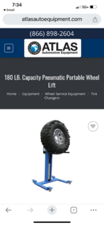

I have a two post lift in my garage. Pulling wheels off my Sequoia or the wife’s Lexus is no problem, but pulling the 35’s off my lifted Tundra kinda *****. They’re damn heavy. I bought this and it works awesome!!!!IMG_3065.png
