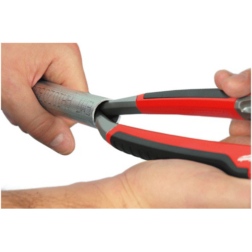

So now I know. I imagine anyone here who's a plumber already knew this, but not being a plumber, I didn't. I'm trying to picture how that curved end gets used as a reamer; I imagine you set the pliers wide, so that the handles are close together, and insert both ends into the pipe together. Right?
Obviously those pliers that have big beefy handle grips like Irwin cannot be used this way:
Looks like Milwaukee has their own idea about this; their pliers have exposed pointy ends which might be intended as reamers:

I’m an electrician and we would purposely trim the end of the handles to look like the Milwaukee. When cutting conduit, we would then slide the handle ends into the pipe and ream the burr off. I ended up getting and using a reaming tool that went on the shaft of a screwdriver.

Hope this image straight from Milwaukee helps:
I could swear I've seen pliers like that with the ends having a more angular profile to ream more aggressively.
