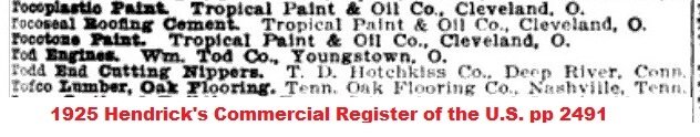

Hotchkiss / T.D. Hotchkiss Co., Deep River, CT / "Todd's Patent" Meriden Cutting Nipper / patent 182615 285446 / (see also Meriden)(see also Todd) / http://progress-is-fine.blogspot.com/2012/04/vanished-makes-carew-patent-cutting.html /
1916 Hardware Retailer T.D. Hotchkiss Todd's Patent Nipper
1921 America's Leading Manufacturers T.D. Hotchkiss Todd's Patent Nippers pp 292.jpg
1925 Hendrick's Commercial Register of the United States T.D. Hotchkiss Todd's Patent Nippers ...jpg
1025 Hendrick's Commercial Register of the U.S. T.D. Hotchkiss Todd's Patent Nipper
