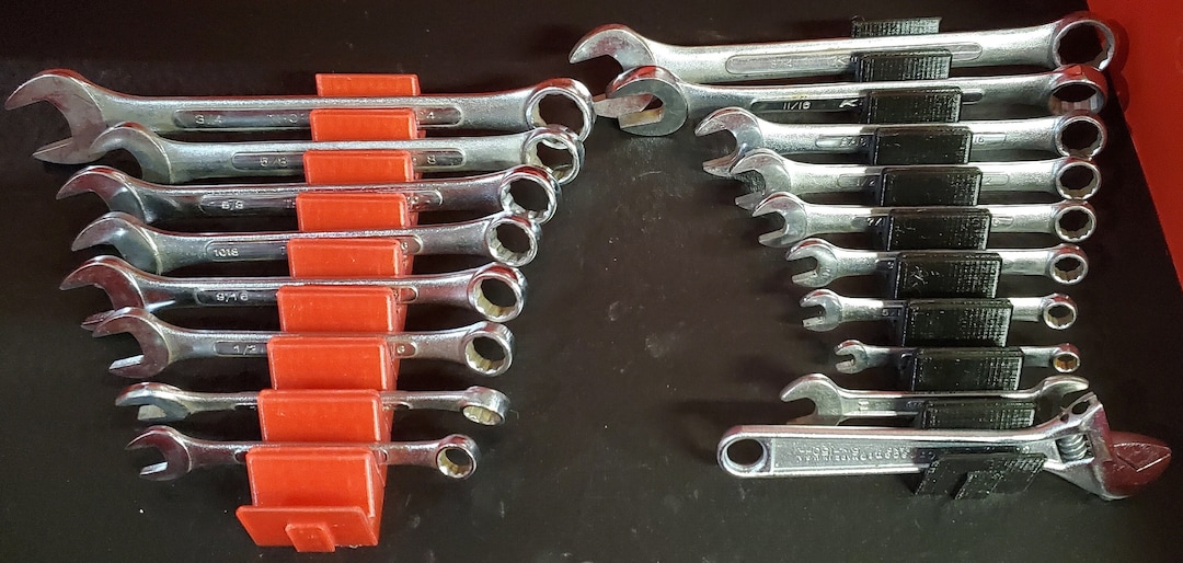

Handily, I've got all my wrenches in the next drawers down. Standard on the left, ratcheting on the right. The smaller drawer has a super nifty set of 3D printed and magnetic wrench holders I can like for however many wrenches I'd like. Currently have an extra space for metric and imperial.
Curious about these... do you have a file, and do the wrenches slide around much? What part is magnetic, the bottom to hold in the drawer or are their magnets that hold the wrenches in place?
Full disclosure: I bought these on Etsy. Wrenches don't slide much but aren't held to the rack by magnets. The magnets are on the bottom and just keep the rack in place within the drawer. What's really cool about them is they interlock, so you can have as many or as few as you need for your given space.
Cheap? Not really, but not all that expensive either. They were the perfect solution for my use. I can fit 18 in that drawer.
