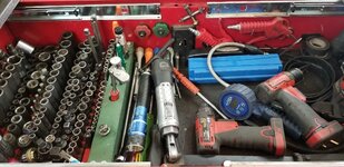

I am using VIM Magrails in my Vidmar box to organize my sockets. They are the most customizable and lowest profile solution out there as far as I know. They are pricey though. Pliers are organized with a typical wire organizer cut to fit the drawer. Wrenches use the plastic wrench rails off the Snap-on truck, also very customizable this way. The dividers of Vidmar/Lista cabinets are invaluable for organization. All of the drawers in my wall of Vidmar cabinets are lined with thin rubber back rug runner carpet sold by the foot at many home improvement stores. The carpet has ridges running perpendicular to the direction of the in and out motion of the drawer, so it helps tools stay in place. It also provides a safe surface so as not to damage your tools from storage, and it will absorb oils such as Starrett M1 oil which I have applied to protect my tools from corrosion. All of this while being only approximately .125" thick, so it doesn't take away much drawer height and the magnetic socket rails can still effectively hold on to the steel drawer below.
