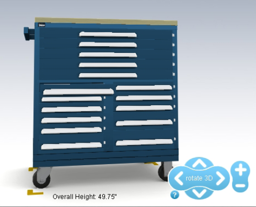

So I asked around Stanley is probably the cheapest for a custom cabinet at $3,417.80 (including the hardwood top)
It might take me a couple more months (especially including freight), but I might go with that.
It's 43" high (without the casters), 45" wide and 27.75" deep.
The top drawers is 5x 2.25" (5 drawers), the left is 5x 2.25" and 1x 4.625", and the right is 3x 2.25", 1x 4.625" and 1x 5.375".
We will see though it is pretty expensive, will have to think and plan a bit for something like this.
