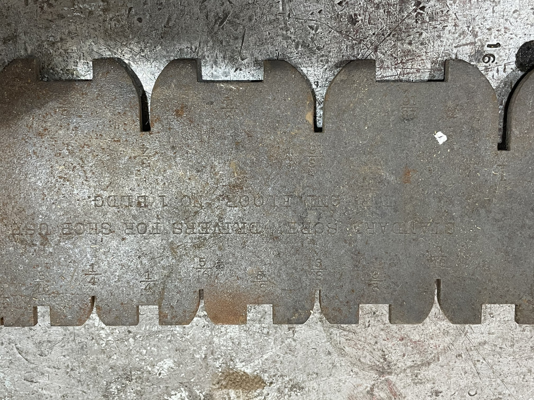

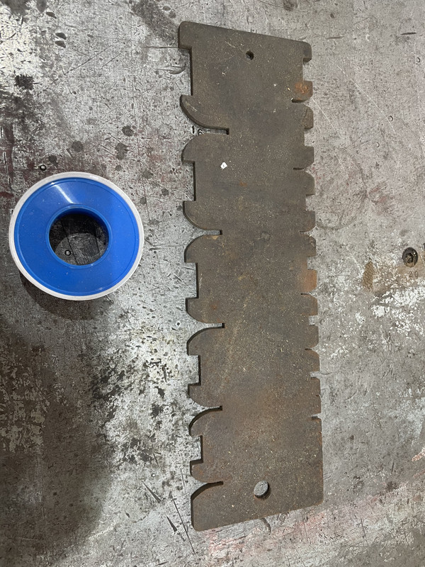

Regular screwdriver guide for both flat and tip
Reads “ Standard screw driver shop use”
“T.R. 2nd floor NO.1 bldg”
Then the gauges also have sizes listed, 3/8, 5/16 etc

It appears well made
I will likely send it along to someone who needs it more than me and can display it with their collection
The two drilled holes are of different diameter
I like the slopes that are cut/filed/punched in to check the tip thickness
Actually, it reads "STANDARD SCREW DRIVERS FOR SHOP USE." I'm not sure how that changes the meaning, or the purpose, if at all, which is still a matter of interpretation to begin with, but it could.
IMO it maybe from a screwdriver factory. Does TR relate to anything?
My guess for "T.R." would be Tool Room. With "2ND FLOOR" implying multiple floors, and "NO. 1 BUILDING" implying multiple buildings, if it's a screwdriver factory, it is a dang big one.
Another possibility is it's a big factory of some other kind and the guide is associated with maintaining the tips of screwdrivers used in the shop and kept in the tool room on the 2nd floor of building No. 1.
Man, that brings back memories. Really.
It's a tool room jig to reprofile screwdrivers... or make them from stock if needed.
One of my earlier jobs required each of us to do "tool room" duty on a rotation basis, and one of our duties when we pulled tool room duty was to do things like sharpen bits, regrind & reprofile screwdrivers, etc.. Since most of what we worked with were relics from the 190's and 30's, keeping flathead screwdrivers in shape (so you didn't waller out screw heads) was kinda vital.
