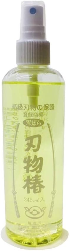

You might want to try Tsubaki oil, this is what the Japanese use on samurai swords. About 6 weeks ago I treated all my own tools with this and I want to see how it works over this winter.
It can be purchased on Amazon for $16 and a little seems to go a long way.
https://www.amazon.com/dp/B001TPFVHC/?tag=atomicindus08-20

LOL just beat me to it....Tsubaki oil from Amazon. Works pretty well with the humidity in Idaho where the desert bumps into snowy mountains. Been using it a few years on tools that see moderate use, and it works very well. Going to try to handle-dip a pair of pre war 1940 Klein pliers that are nearly mint and have been treated with Tsubaki oil a few times; I will report back on how well the dip works. EDIT....decided to install Kleiin Koats on my 1940 Klien Lineman pliers; no dippin.
interesting suggestion. i guess that's oil from pressed from seeds of Camellia japonica, a relative of the tea plant. i suspect that it may oxidize and gum up over time, but idk. sounds promising if it doesn't. let us know how it goes!
there are other traditional japanese oils like choji oil (contains some amount of clove oil). it seems like many don't recommend using it anymore, even on old, precious swords: http://www.militaria.co.za/nmb/topic/2558-choji-vs-other-oils/
I agree about unscented mineral oil. I get mine pretty cheaply at Ace Hardware, and it works wonders on butcher block for me. But I find that oil as a rust preventative is not so great, because it doesn't stick around.
As for plant based oils, some are good and some are not so good.
Camellia oil is unsaturated, so it does rancidify. Then again, the same can be said about linseed oil, which we all know does a good job at preventing rust. However, as it rancidifies, it hardens. The in-between sticky phase where it's no longer oil and not yet a varnish is, well, nasty. Camellia oil's makeup is pretty darned close to that of olive oil, being largely oleic acid. And while it does rancidify, oleic acid is actually well known to protect metals from corrosion, and even is used to reverse some corrosion damage (particularly on copper).
Then again, not all plant "oils" rancidify, as some aren't even oils (that's the reason for the quotes). Jojoba oil for example is a wax chemically, that's just liquid at room temperature. The chemistry of jojoba oil is nearly identical to that of sperm whale oil, which also does not rancidify, and that explains why jojoba was one of the earliest oils used to lubricate machine guns (WWI era) before synthetics became abundant.
