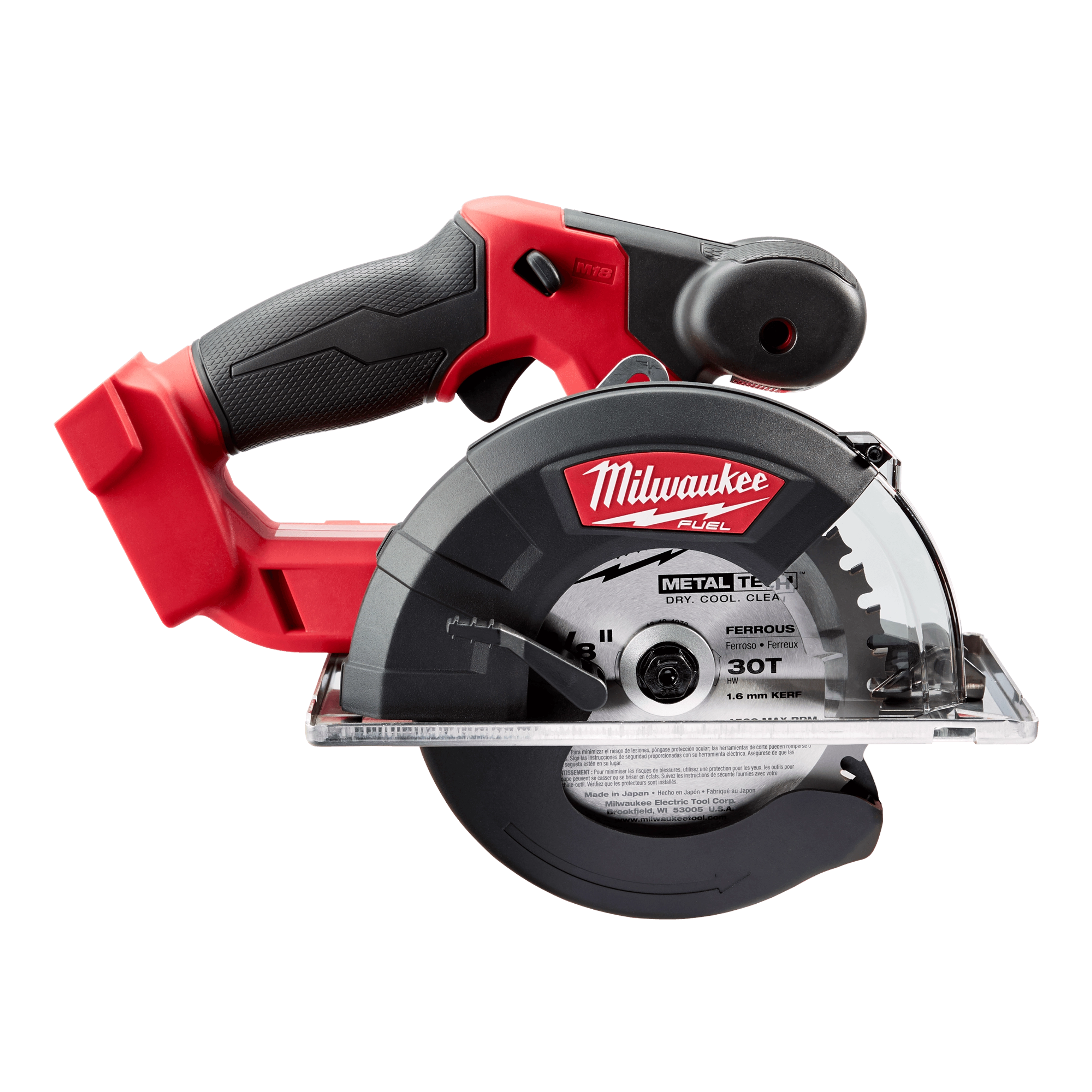

If anyone has a cool tool or idea on how to best cut these ducts, please let me know. We cut enough of them to look at a dedicated tool, but it would have to be highly adjustable as we deal with a variety of sizes.
This will work, have used it to cut lots of spiral ductwork:
Have also used the corded version of this, has much better chip containment than the one above:
Both are quite loud in use, but there probably isn't anything better for the job. If the blade is sharp, it won't grab. Problems start shortly after the carbide teeth start breaking. No black **** like cutoff wheels.
Double cuts will work, but a starter hole is needed. A straight cut is also HIGHLY dependent on the operator of the tool. Stainless will chew up blades.
A Milwaukee Hackzall with a fine tooth blade will work. I actually prefer this method, but I have made lots of cuts and am pretty good at it. Getting fine tooth Torch blades was the hardest.
I have seen a spiral duct cutting station on a job, but it was missing the cutting implement. Pretty sure it was a Lindab SRCS2.
Full disclosure, I have been cutting spiral ductwork in some way, shape or form for a long time, on a jobsite. Definitely not every day, but i have cut a lot of it.

Metal cutting saw, angle grinder, reciprocating saw with the proper blade or double cut shears are really the best choices. I have used a jigsaw with the proper blade to cut round holes in stainless steel stuff like kitchen hoods.
An oscillating tool with a carbide blade can do it, but it is also super noisy, and very difficult to start cleanly.
Starter holes for double cuts need to be offset to the "waste" side of the planned cut.
A proper 24tpi Sawzall blade works wonders in thin metal, but they are not typically stocked.
I frequently use a "dull" Sawzall blade for deburring. Just run the teeth on the inside of the cut. Works great.
